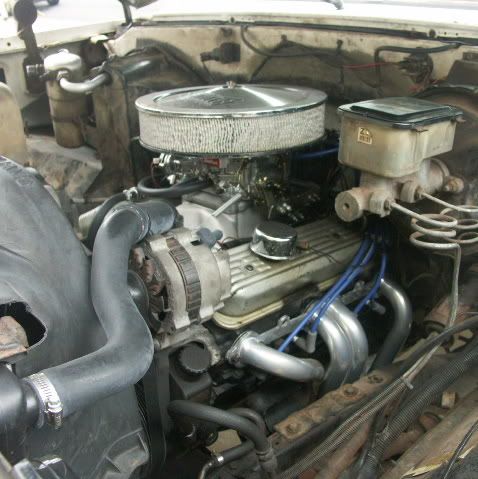

the truck is a 350 straight carb'ed, intake and headers, no cats atm.  No electronics at all.  The motor in the truck NOW started life as a TBFI motor from an IROC GTA if i remember correctly from what i was told about it.
The thing is that how will they evaluate the set up?  Will they hold the motor to a v6 standard of emission because the truck started its life as a v6, or will they have some kind of system for determining what an "acceptable" level of emission is for the motor in it now?
Hmmpf, looks like really need to get on the horn with a professional in cally before i do anything.  They actually call people that work for the state's emission compliance "Referees?" LOL
we'll see how it turns out.  I'm going to be livid if it costs thousands of bucks to get it registered legally because i have to install some electronics, i'll pull the motor in my carport and sell the body for scrap metal and drop the motor into a dune buggy if that happens....  :P ::)

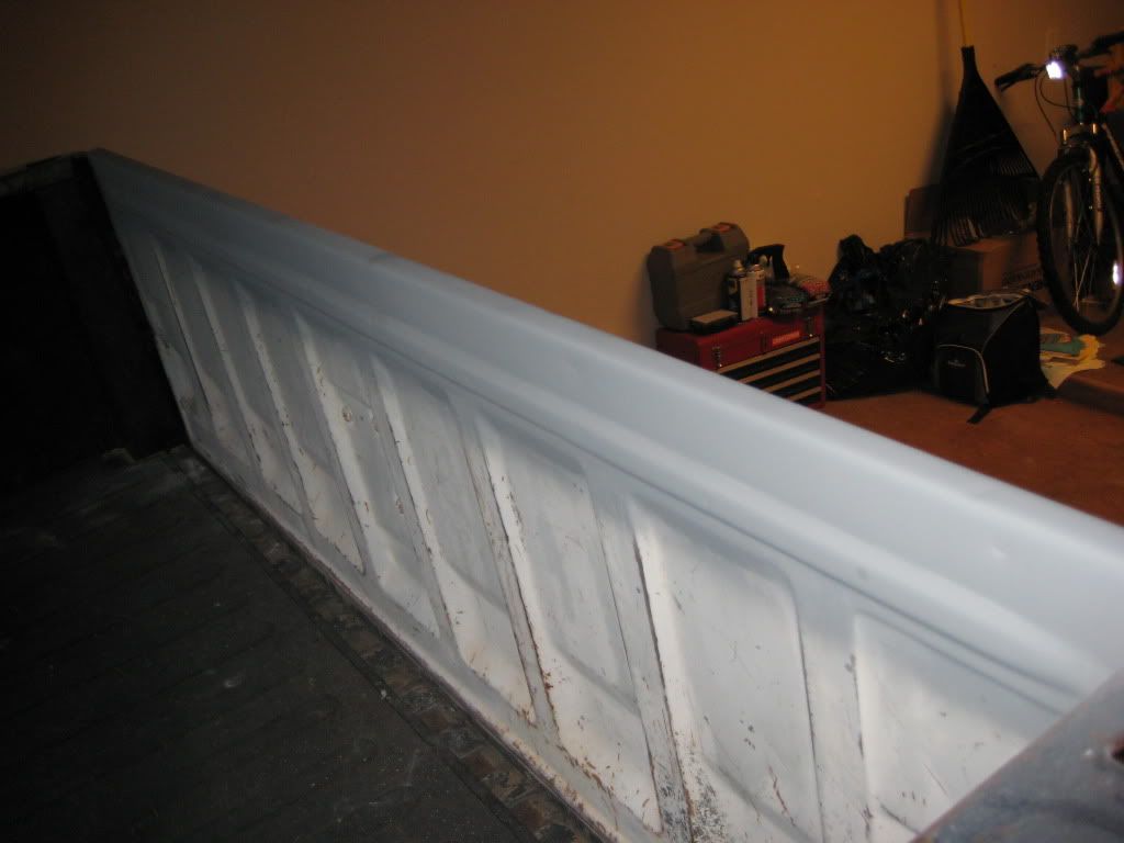

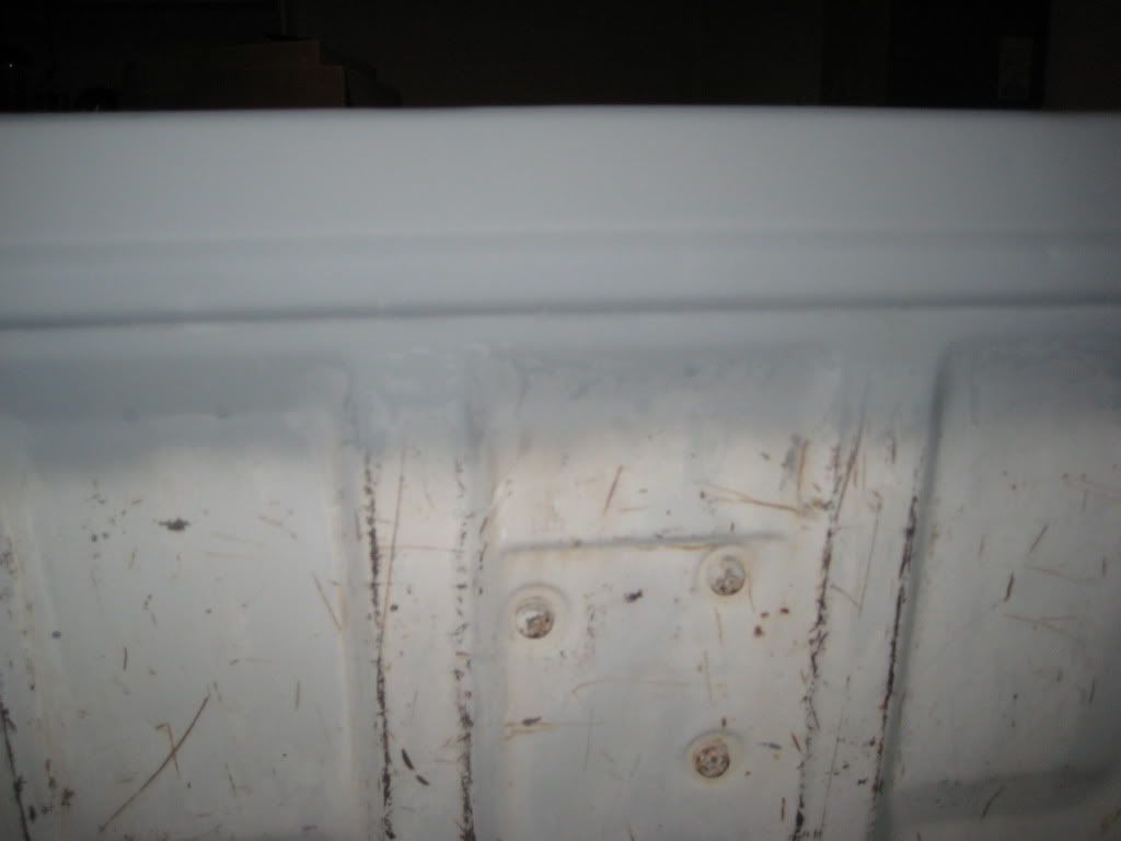

the body has a LOT of surface rust but no bad cancer except for around the doors.  This is the start of me trying to clean up the pain from the tail gate...

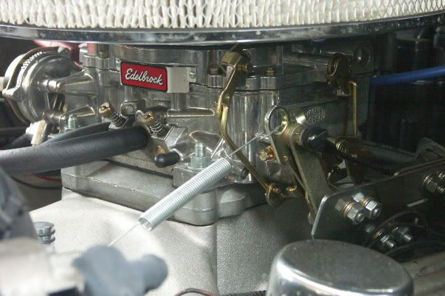

You need to turn that fast idle screw down a bit.
Offline anderskorn
  • Posts: 10
Re: 1985 c10- headed to LA
« Reply #13 on: June 02, 2009, 10:24:46 pm »
i knew someone would notice that!  yeah i should be shot for not actually spending an hour reading the book and watching the video that came with the carburetor.  now its in LA, went with the pack out.  I can't wait to start getting my tools and garage set up the way i want it after i get there!
