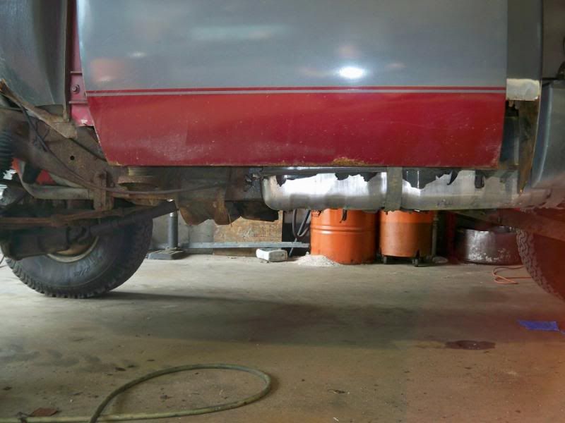

Started this project a few days ago. 83 Cab on a 76 Chassis. Second time around for this one. I patched the drivers floor, put inner, and outer rockers, Cab corners, inner fenders, outer fenders, & doors on it about 12 years ago. His brother inlaw owns it now, getting it in primer, and he is going to paint it himself.
Everything but the cab support, and mount cut out.

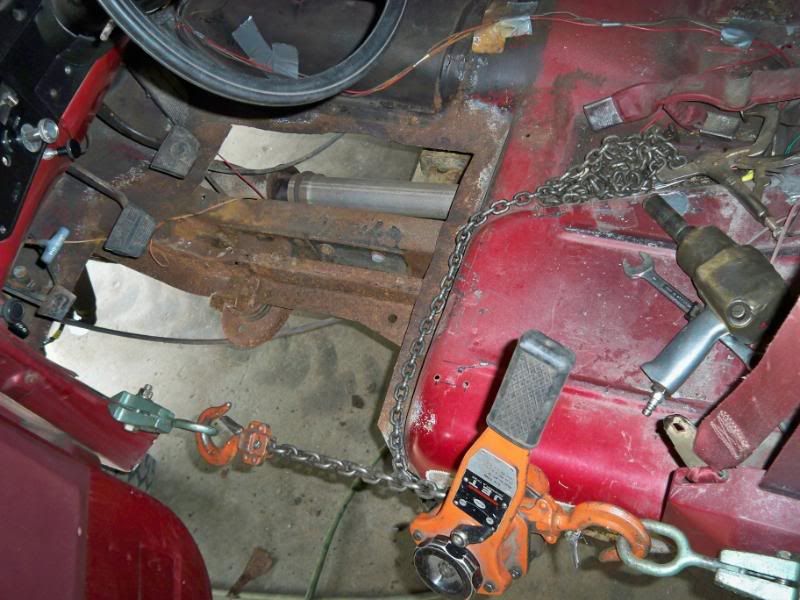

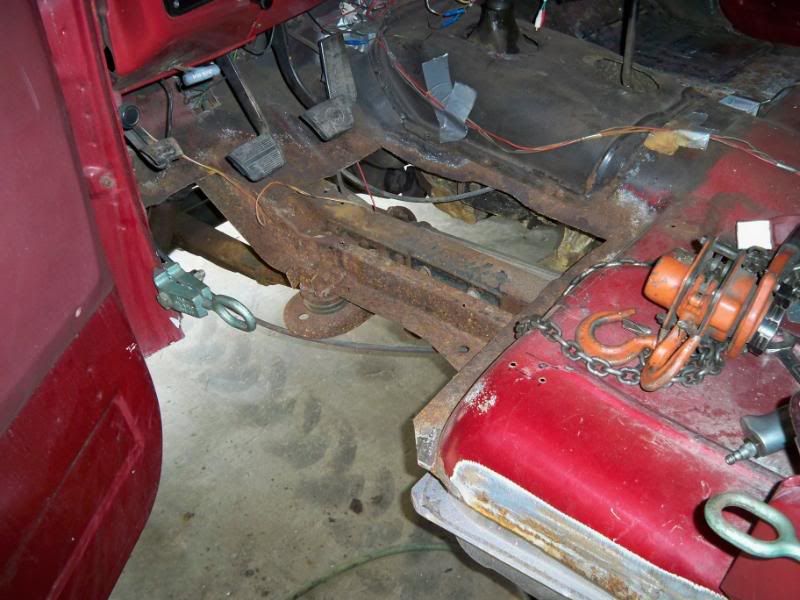

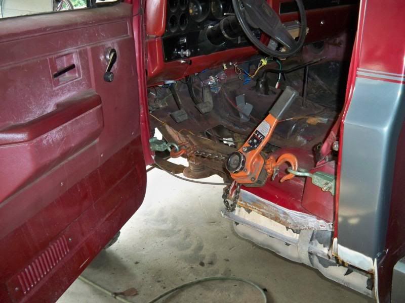

Clamps in place to pull cab back together. Door opening was 7/8" wider than the right hand side. Cab had spread open so the latch was trying to catch the nob on the end of the sticker bolt!
Cofin hoist works good here. I have a pull ram for my porta power but the fiting is snapped off in the side of it.

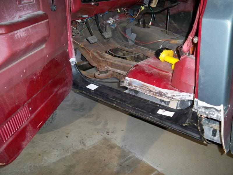

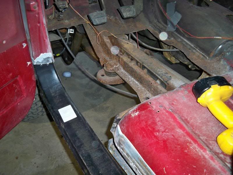

New outer rocker screwed in place.
Now I can cut out the mount, and replace it.
