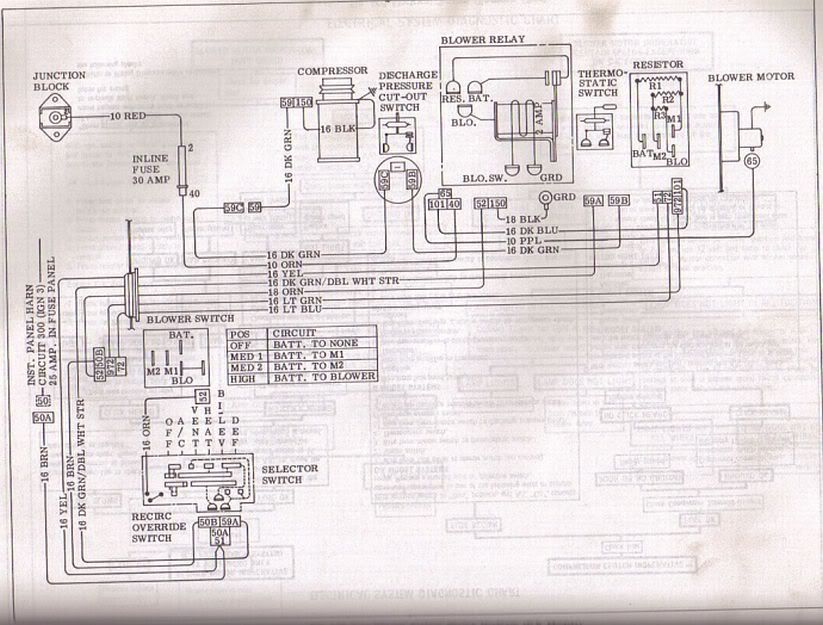

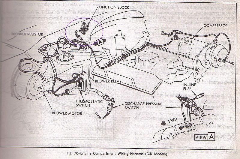

Also I have a missing fuse, it comes off the junction box on the firewall and goes to the blower motor plug. What amp fuse is it? On the wiring sheets I printed from here it says 4 amps. Is that right or im looking in the wrong place?

The fuse holder goes to the blower relay. The truck did have factory AC if that makes a difference. The in the last picture, i pulled the harness through the firewall, thats all the wiring for the heater/ac.

The fuse holder is factory.

Here I scanned a pic.. 30 amp inline fuse

Thank you so much Vile ;D I appreciate it.
