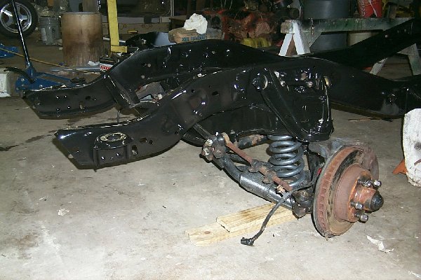

Every frame rail on either 4x4 or 4x2 are identical.  That is why it is possible to convert a 4x4 to 4x2 and vice versa.
Not the best pic, but here is my 2WD frame
http://www.captkaoscustoms.com/images/beginfrtsuspr.jpg
Here is a 4x4 frame from CK5:
http://www.coloradok5.com/ordframebrace/P1010005.jpg

Sure, that would easily take care of one side........but then how would you propose to take care of the other plate which has stamped contours to match the frame???
I'm not beyond fabrication.....but I'm not about to "hillbilly" something either.......
Thanks for the clarification Capt.  I greatly appreciate it.....
