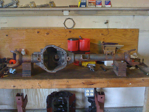

Dana60 before:
Dana60 as of today:
Still need to get the pinion out, and replace the king-pins. Then it will get the treatment like the 14-bolt has. New king-pins torque to 600 ft/lbs. Removal of the old KPs will probably exceed 800 ft/lbs breaking torque.

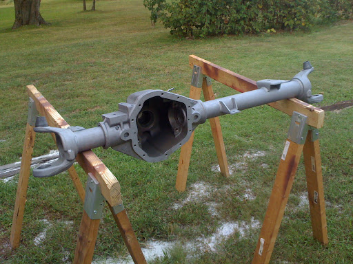

After caustic tank, before sand blasting:
After sand blasting:
Before I sand blasted the D60 I torqued the king pins into place. Those babys torque to 600 ft/lbs.
Not 60 ft/lbs, 600!
Now some primer, and paint, and we can start the reassembly.
