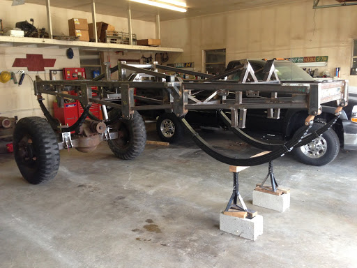

The best I can do is a picture from the mock up phase with a couple of the military 11.00-20s on it:
Looking across the frame you can see how it dwarfs the 2500HD behind it.
