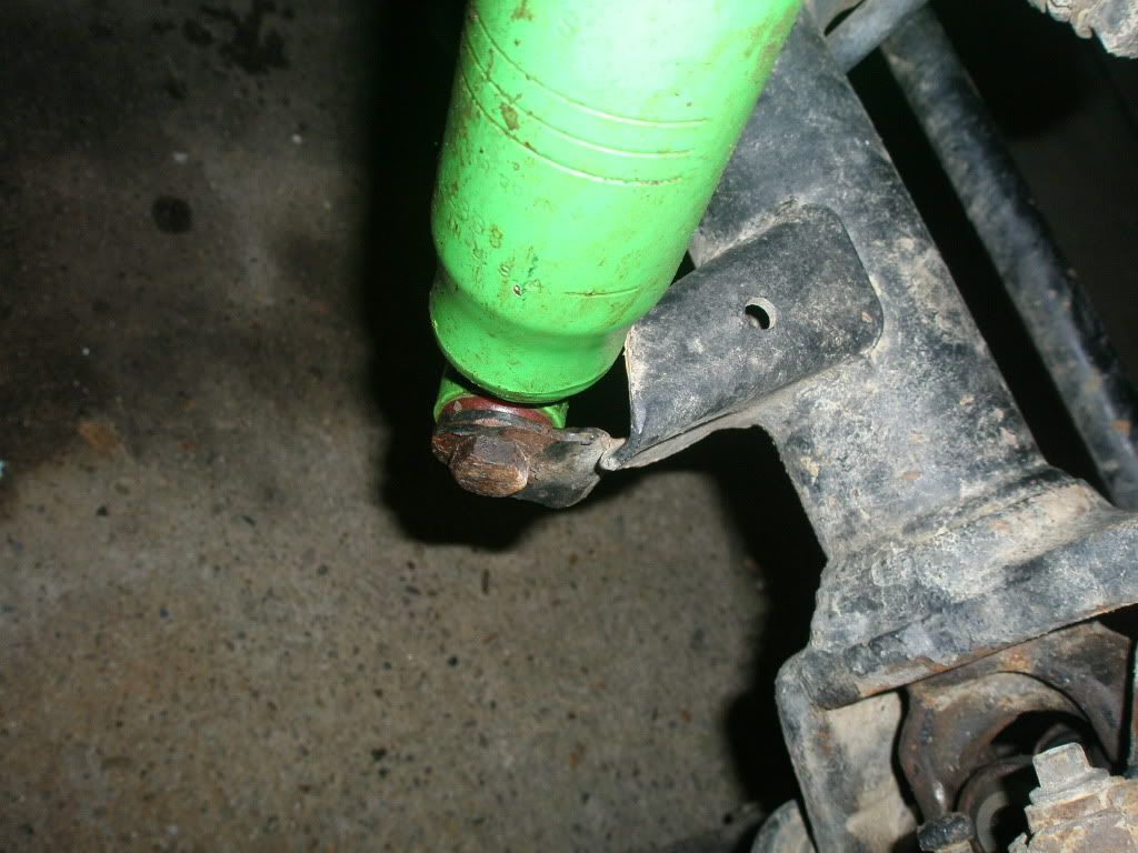

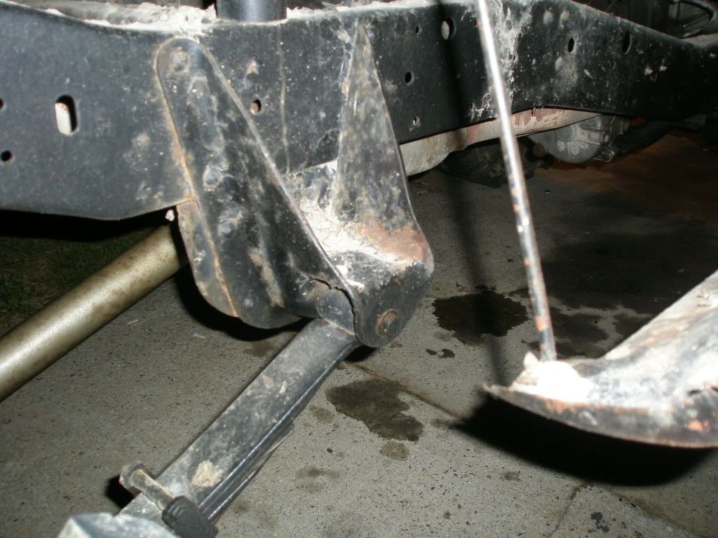

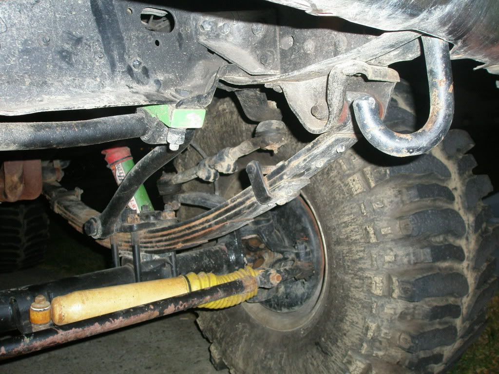

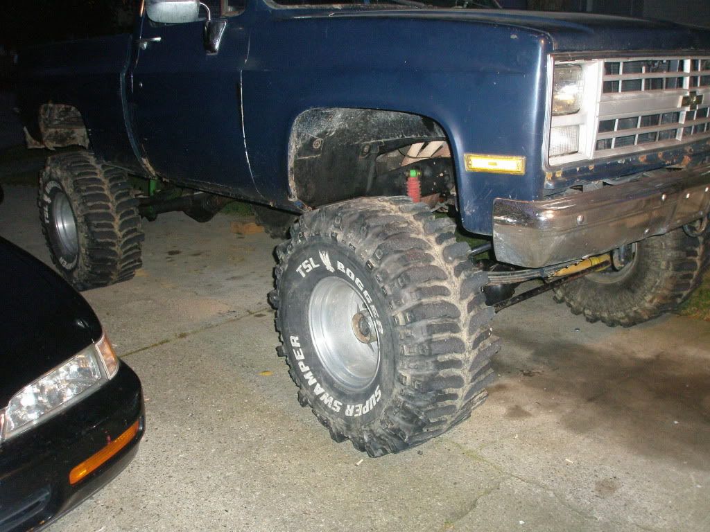

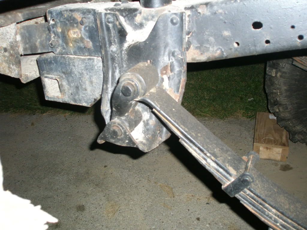

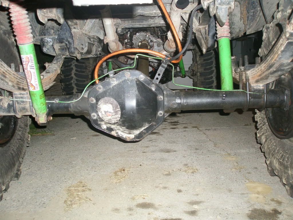

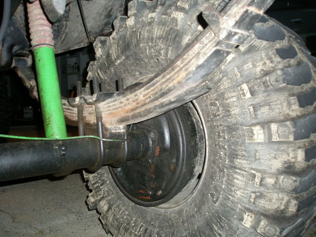

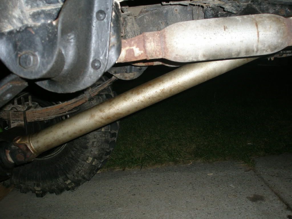

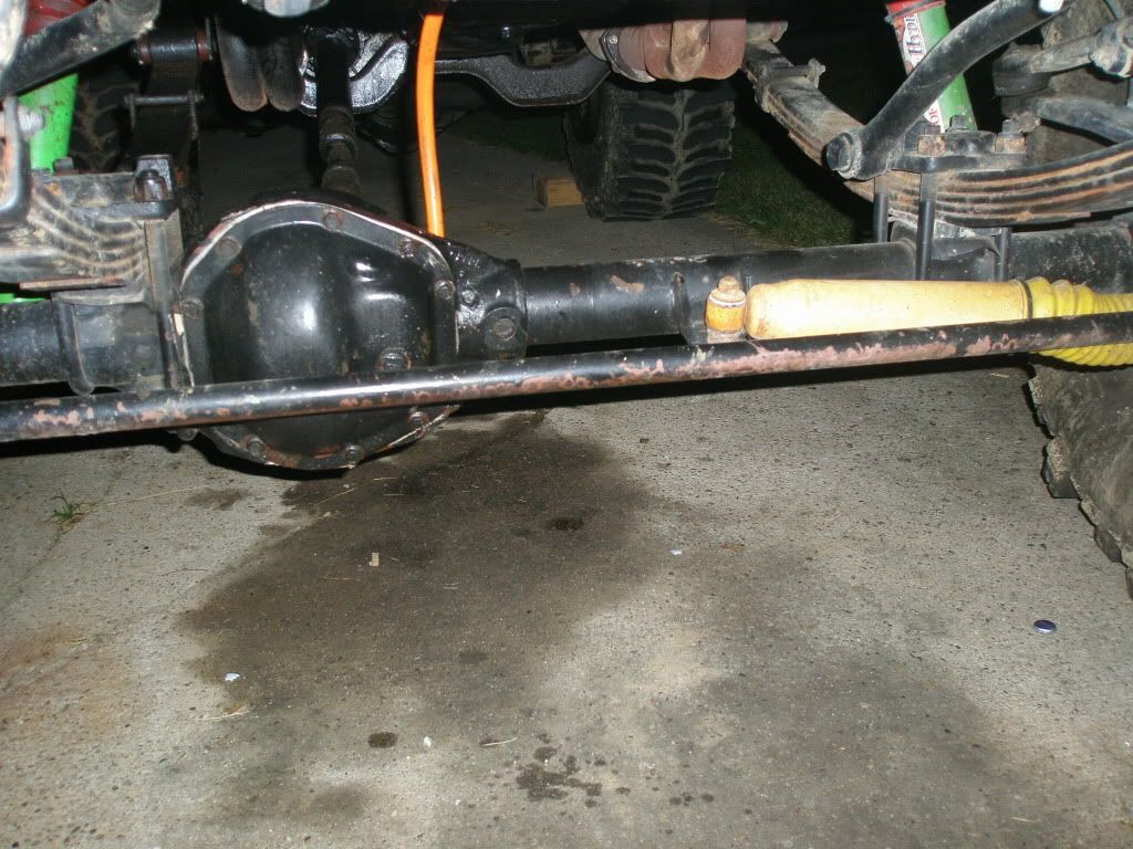

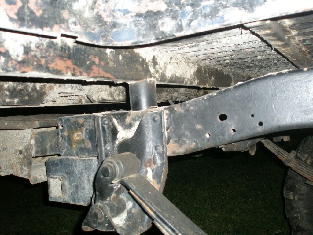

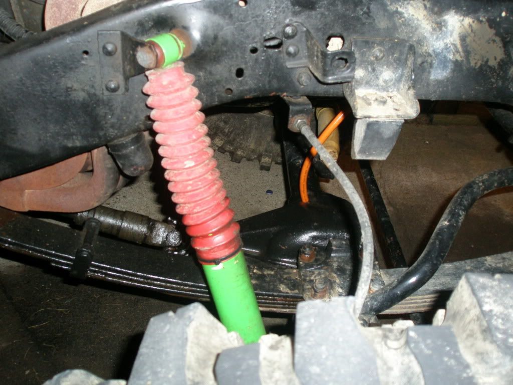

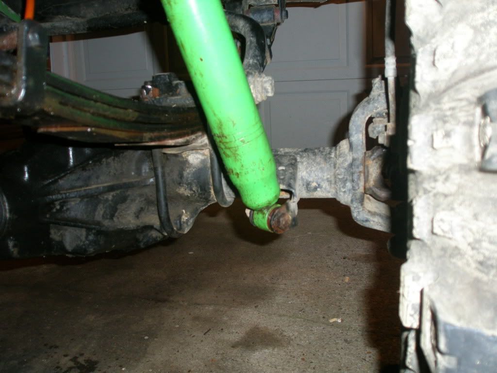

i took shots of everything i think
found this when i was poking around is there somewhere that sells these bottom holders or do i have to fabricate it.
i think this has been lengthened
dana 60?
Posts: 19255
Re: Simple way to lower my monster truck
September 10, 2009, 07:56:13 pm »
Looks like a 6" suspension 3" body lift to me. Just take out the body lift.

cool, i have been looking at the energy suspension replacements. Im probably gonna go with that one because i have put them on other cars and they work well. what about the shock mount? fabricate or is there somewhere that makes them?
Posts: 19255
Reply #12 on:
September 10, 2009, 08:12:40 pm »
Just bust out the welder
