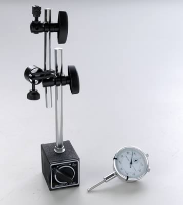

get your self some "blue" oo any off color grease if not supplied for contact pattern. or use the stuf supplyed.
measure back lash BEFORE removing the carrier. then reset the new carrier and ring back tot he previose back lash seting. this will allow and is critical to maintianing long R&P life.
you will need this to measuer back lash.
http://www.summitracing.com/parts/SUM-900016-1/
bearings get pressed on to the carrier ends..
no press..
here is a trick place the bearing in the over heat to ~350*F this will case the bearing to expand. about .001-.002"
place carrier in a bag. set bag and carirer in ice water. this will case the case to strink .001-.002"
then drop bearing on case allow everything to warm up/cool down nauturally ore palce a fan on it.
i would get this going before you start draining the diff and what not..
race. that is the part that slips over the bearing. the bearing goes on the carrier.
and yse you will need a dial indicator and base. see above link :)
caps.. if they dont have arrows. (they should they both face the same direction)  fit them up on the axle housing they should be flush on the in-board side.
and most important take your time or you will be re-doing it ;)
