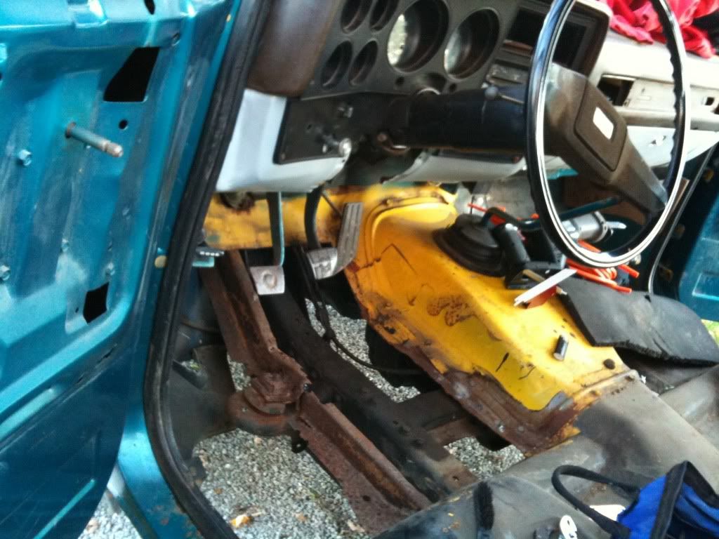

malibu795
Posts: 336
Re: frame, body, cab ETC.... not 56k friendly
Reply #13 on:
November 18, 2010, 10:26:12 pm »
old panels removed.. got the new one in there still need to raise the cab another .5" to get the floor to line up with rocker panel
heres a nice poser shot too.. the mound is ~5' high and truck is still 2wd havent bought a new on yet.
shock/suspension 24" shock at full extention.. need longer shocks
