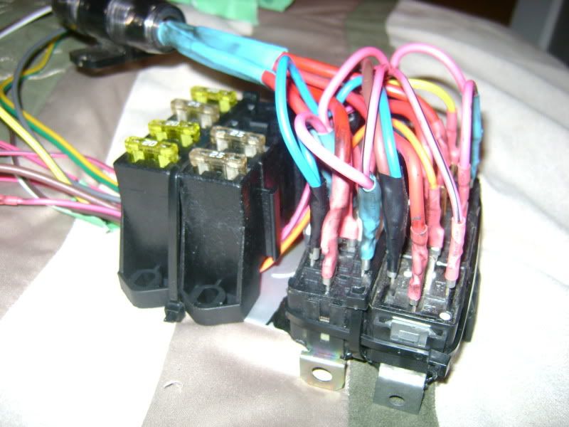

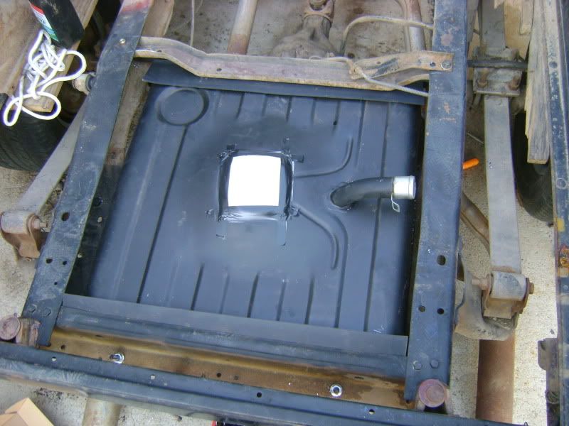

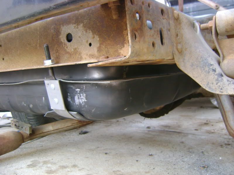

Made a little progress today.  Got the blazer tank mounted.  Sat and looked at the battery trying to figure out a way to mount it in the void that the tank once occupied.  Mocked up a battery mount using the tank strap and mount.  Still needs some work but i think it will work well and best of all it was free.
Still trying to get all of the emissions wiring figured out and waiting on my motor mounts to get in.  Got the wiring all setup with my fuse block and relays for everything all in a nice little bundle.  Hopefully i can get more done next week.  Here are some pix.
