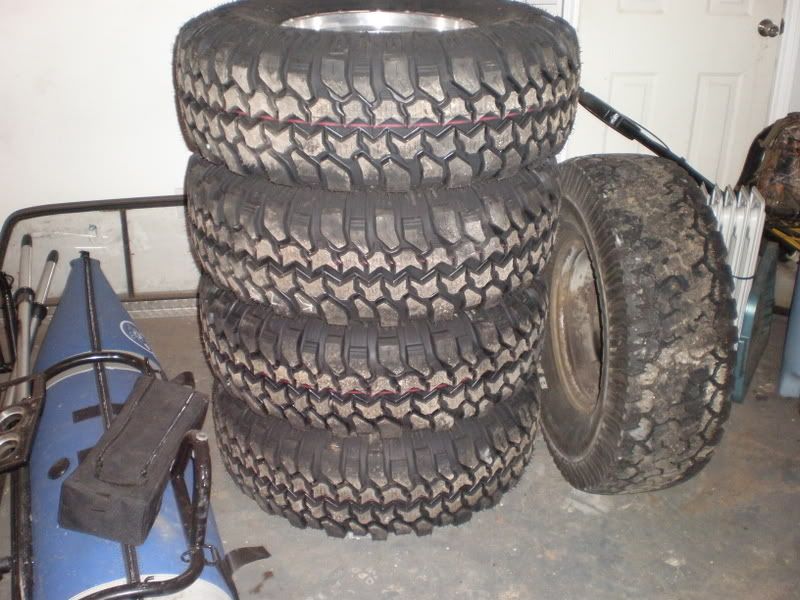

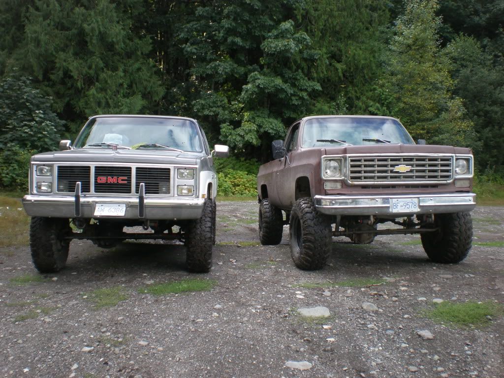

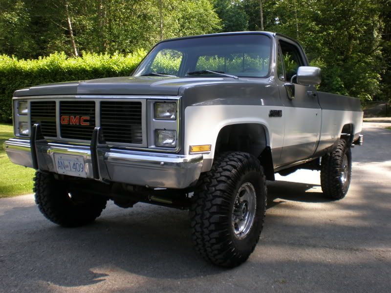

Does somebody have a pic of a 35X12.5 on an 8inch rim
Offline captain carnage
  • Posts: 143
Re: What's the widest tire you would put on.....
« Reply #8 on: December 24, 2009, 10:23:05 pm »
yup,
the ones in the stack are on 8s
and on the truck
Heres a straight on shot, however they look quite narrow compared to the 14.5 irocs on 10 inch rims :o

they look ok, but personaly there is too much sidewall bulge.   i have noticed that the 12.5 don't actually measure out.   they are actually more along 10".
« Reply #10 on: December 25, 2009, 03:33:19 pm »
Too skinny lookin and too buldgy...

What size lifts do you have in your trucks captain carnage
  • Posts: 143
« Reply #12 on: December 26, 2009, 09:13:25 pm »
A 4 inch susp. in mine on the left, and a 4 inch susp., with a 3 inch body on my bros.
