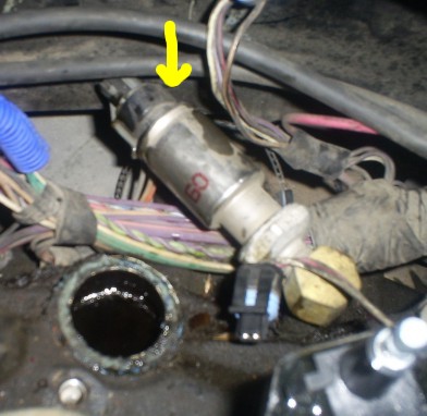

1st check the wire from the sending unit. Make sure it's connected good and clean. Observe the gauge, if it doesn't move ground the wire and see if the gauge moves.

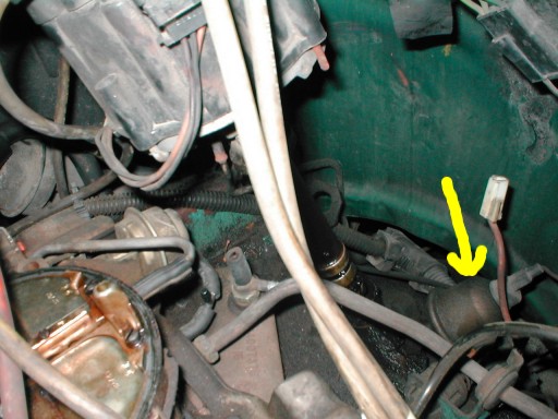

If it's a small block chevy look towards the drivers side rear of the engine near the distributor behind the intake.

You can do a simple test if you wish when you change your oil.  Put a new oil filter on it.  Don't put oil into the filter when putting the new one on.  Run the truck for a few seconds.  Remove the new oil filter and see if oil is in it.  It'll tell ya if the good ole oil pumper is working.
before you condict this test though do as suggested.  Look behind and to the right (driver's side) of the distributor.  You'll see the oil sender.
My '91 did the same thing as yours.  I found out the sender was bad.
