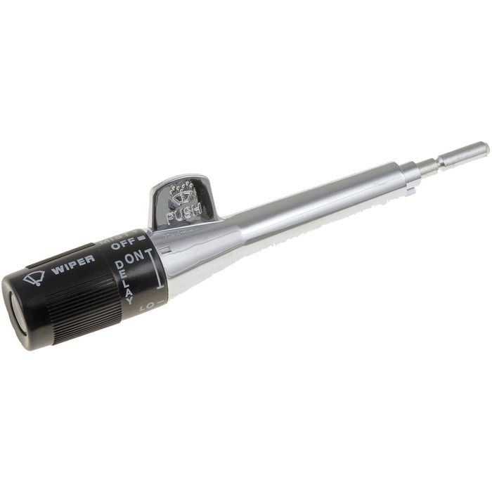

The lever should have a shaft coming off the end of it the shft then slides into the cam. Goto autozone.com and look for the turn signal lever and compair it to yours
Re: turn signal lever
« Reply #8 on: January 13, 2010, 01:03:40 am »
should look like this
but yours may be black
