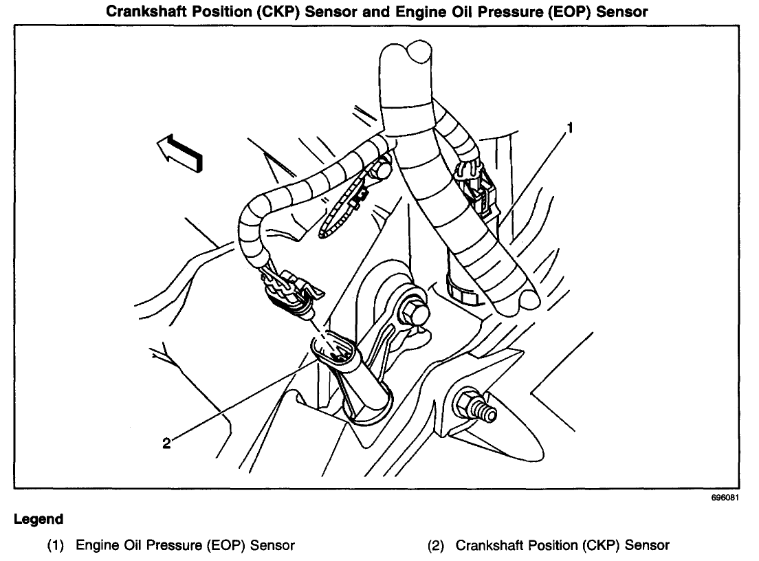

It looks like I'll be doing it myself. The dealer said there wasnt a current recall for my truck.
Where is it located? I cant find a service manual for this truck, but I have heard you have to remove the starter.

Josh454
Posts: 127
Re: Truck dies
February 11, 2010, 09:31:34 pm »
It's located on the very back of the engine near the bellhousing. Just slightly towards the driver's side.

February 11, 2010, 09:32:56 pm »
Its official, crankshaft position sensor. Thanks SgtDel,Josh454 and everyone else. Ill get it changed when I can. Thanks again guys
