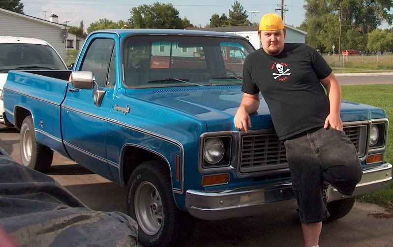

Well which would  let me retain more payload? I don't mind losing some but i like my truck to be a truck somewhat. Like I said this will be the first truck i will have lowered i always wanted to lower my 74 Cheyenne. Btw dont mind the fat kid in the pic...its just me in high school lol
