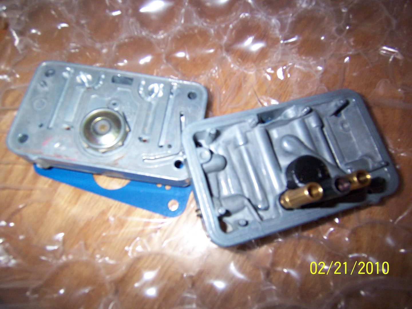

Guys, Yes a boost referenced regulator to raise the fuel pressure as boost comes up is part of the equation. Of coarse there is much more to it with the "fuel curve" as was mentioned.
 People have come up with some pretty unique ideas for this...some include: one injector in the charge tube (with a pressure switch) that sprays at 100% once the engine comes into boost, fuel solenoid/jets from a nitrous kit & the most popular method...modifying the carbs "power enrichment" circut to flow much more fuel than originally designed. Some means of control (boost, co2, air, electric, ect.) seem to be the better working systems.
 I'm sure (as with anything new) there will be quite a learning process.
One BIG advantage for me & others at this point, is that (like this site) many people that have made the in-road are very willing to help.
 I've been building the carb for a couple months (hobbie time has been a minimum due to work, family activities & SNOW removal) with the help of some great guys. Here is a photo of the metering blocks, I paid a fellow (Brent Davis) to do them...He has been a big help to many with blow-through set-ups. I felt that for the money he charged, it was a good plan for my first attempt & also "gives" him a few bucks for something he likes to do, sort of a "Thank You" for being there.
 The power valves are modified & will be controlled by air, the restriction channels opened up conciderably...this allows a more "normal" jet to be used so the engine runs correctly out of boost, among other mods.
 That's all for now, Lorne

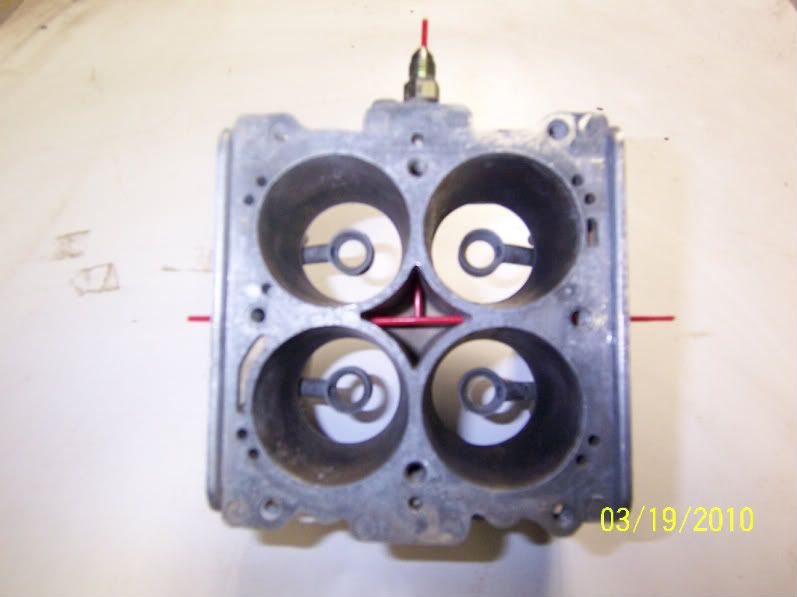

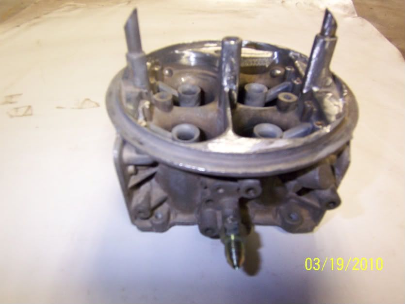

« Reply #24 on: March 20, 2010, 03:02:39 am »
With an hour here & there, I got the carb built! I can't take any credit for the designing/planning of what & how to make the carb work under boost. Brent Davis came up with pressurizing the power valve cavities that originally used vacuum to hold the power valve shut...now the air will push them open. Not much to look at & but let's hope it works!
 You can see in the photos (Red carb cleaner straws) where I drilled through the main body to make "air passages" & where the body is threaded for the external fitting for the air hose. Lorne

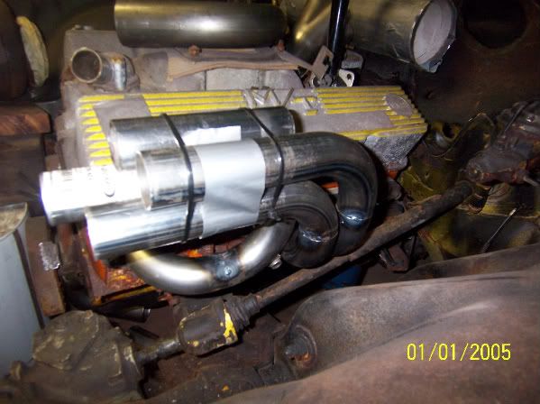

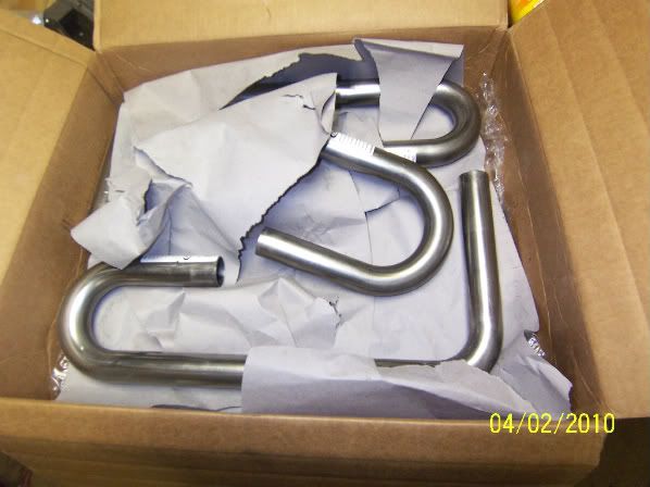

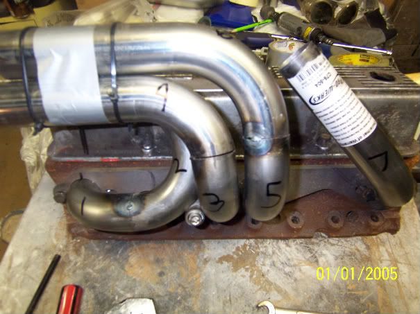

« Reply #26 on: April 08, 2010, 09:14:35 pm »

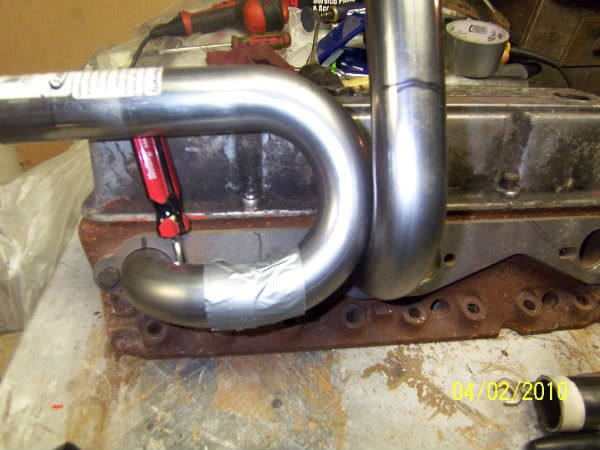

I got a couple boxes the other day...Somebody forgot to attach them! ;)  Just kidding
 Got a few hours in planning, fitting, ect.
 Moving Along
 Getting Closer!
 Just about done!
 Need to finish the rear tubes when the 45* bends come, trim back the ends & install the collectors & V-bands. More pic's to come, Lorne

Nice looking headers you got there Lorne.

Nice looking headers !! Where did you get all the piping, collectors, v bands, ect from?
