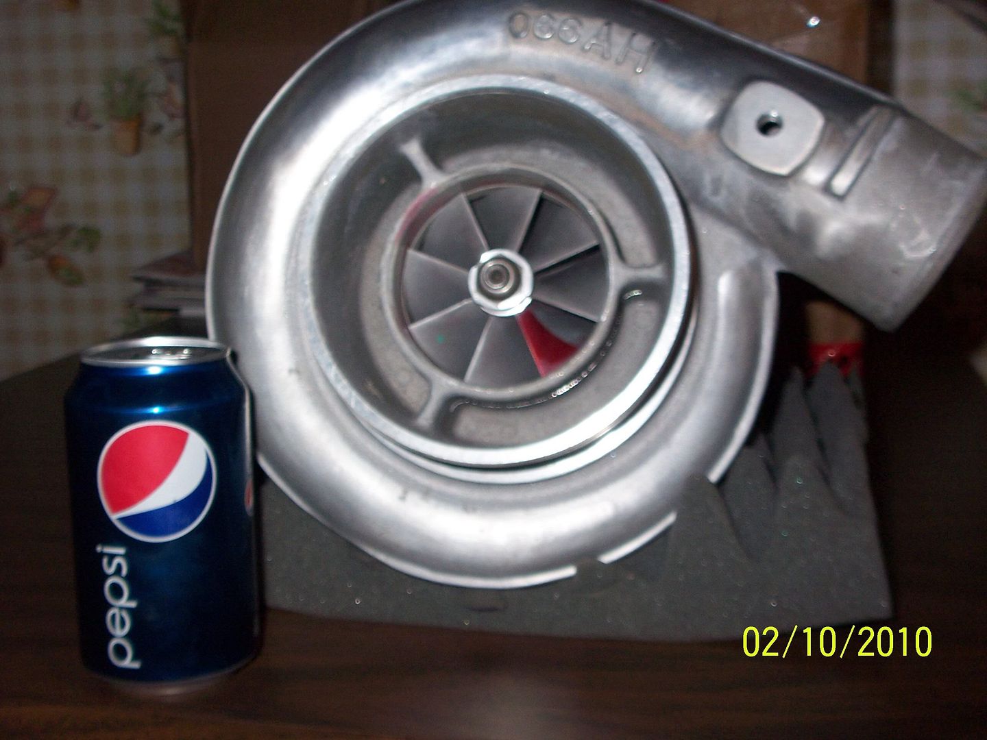

February 12, 2010, 05:22:23 pm »
This should help!
Details to follow. Lorne

February 12, 2010, 06:21:00 pm »
How is a can of Pepsi going to make you go faster??

February 12, 2010, 06:36:56 pm »
I think he is talking about that industrial blow dryer...

February 12, 2010, 08:45:21 pm »
Its the caffeine in the Pepsi! Red bull gives you wings, Pepsi gets you spooled up!

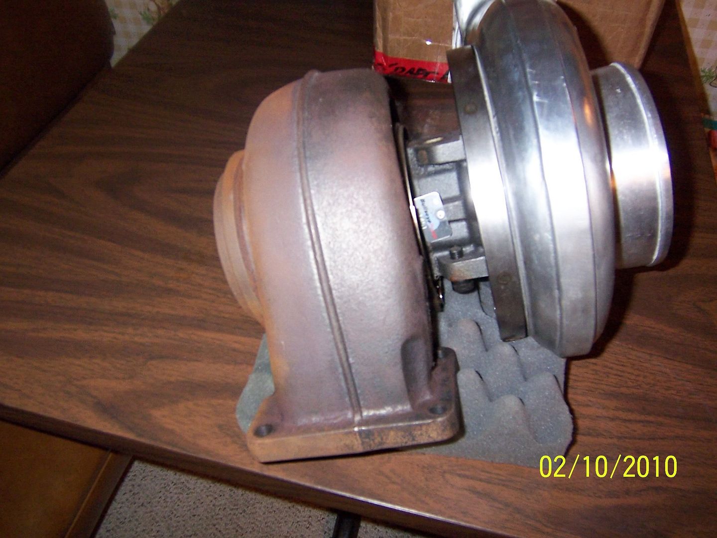

February 13, 2010, 11:31:49 pm »
Guys, Here's the basics of the plan. The truck is going to be a rolling testbed for my turbo set-up since it is in one piece & has been tested a bit at the track. I've been researching & gathering parts for over a year now...real fab progress won't start for another month or Two
due to being crazy busy at work.
The turbo engine is actually for my '73 Vega that I bought in the summer of '87. It's been in the back corner of my garage since '89.
I'm going to build the headers/hotside, coldside, ect. in the Vega then transplant it all to the truck for testing. As long as Chris doesn't mind some "car" underhood shots on here, I'll post the build as it goes together...otherwise once it's in the truck you'll see pic's.
The engine is a basic steel crank, forged rods/piston 355 Chevy, the turbo is a T-6 based Bullseye Performance 80mm. I'm working on a Holley 750, modifying for blow-through. That's about it for now...should make the "Black Box" a little quicker
Lorne
