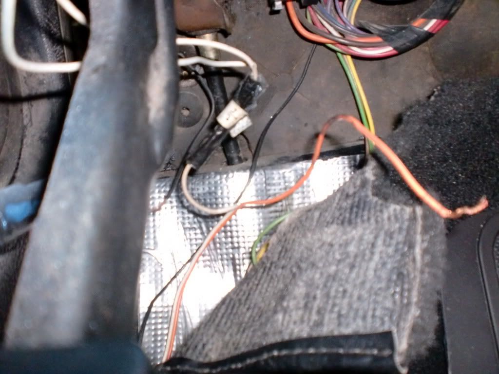

ok ive finally gotten time to work on my truck again, and want to knock out my dome light problem. Ive gotten the floor light to work a while ago, but i dont know how to wire the dome.
the white wire is connected to the grounds going to the door switches and the dash switch(pretty sure anyway) but the orange wire is cut and hanging by the carpet. Where does this plug into? the fuse panel to a constant power? or is there a spot on the dash switch that gives it power

heres a pick i just took to help clarify where it goes. The white wire joins the one going between the boor switches and the dash switch, and the orange one has been cut and i dont know where i connect it.

I just looked at mine.  My orange and white wires go into a short electrical taped section that looks like your pic.  I haven't taken that tape off so I don't know if there's a fusible link in there or what but it (the orange wire) then comes out as an orange wire with a white stripe that plugs into a bat connection near the bottom of the fuse panel.  Hope that helps.

ya so i should never doubt the abilities of my truck, after all my hunting for a broken wire, apparently i put a single pole bulb into the socket that had 2 poles and that was causing the short in the wires.
after all this a correct bulb and a constant power source and blam
DOME LIGHT (first time in 2 years)
