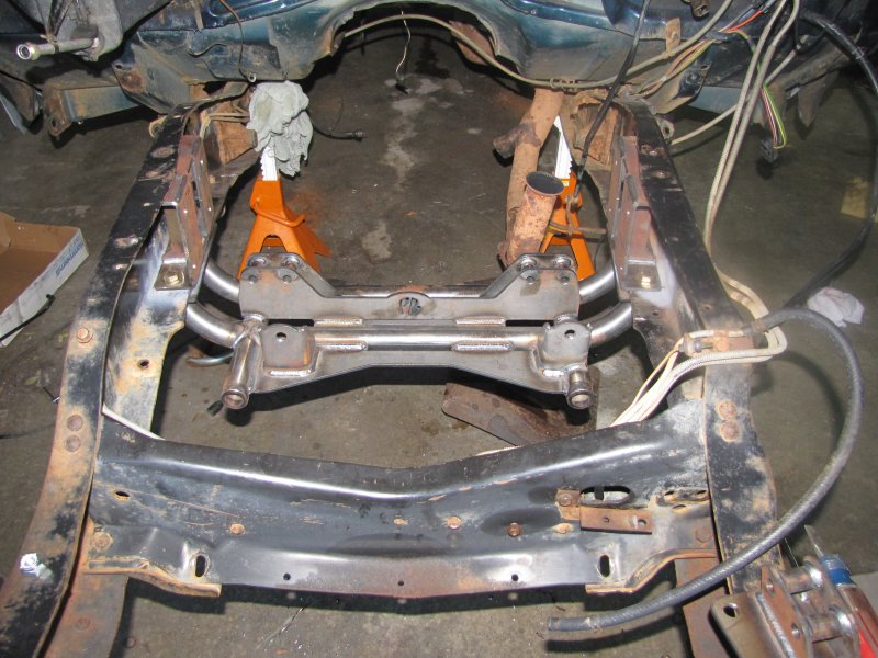

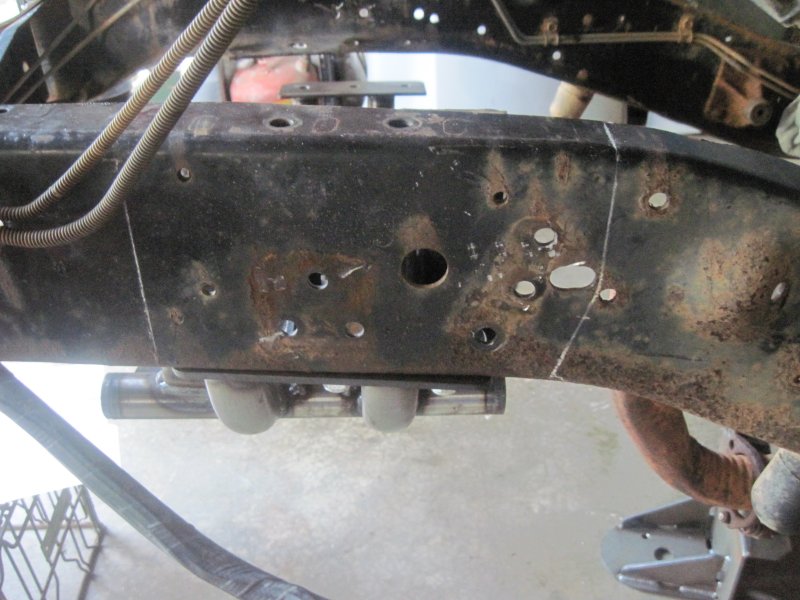

Sunday, Oct 2nd 2011:
Buddy came over in the morning and with some measurements and double checking we made a jig to located the holes and commenced to drilling. 1 Hole on the passenger side had to be center drilled with a smaller bit due to it overlapping an existing 4x4 specific hole and then ground to fit. There is no turning back now, the main Porterbuild dropmember is in, I got the 2 outside brackets to mount/locate and 14 more holes to drill to get them mounted.

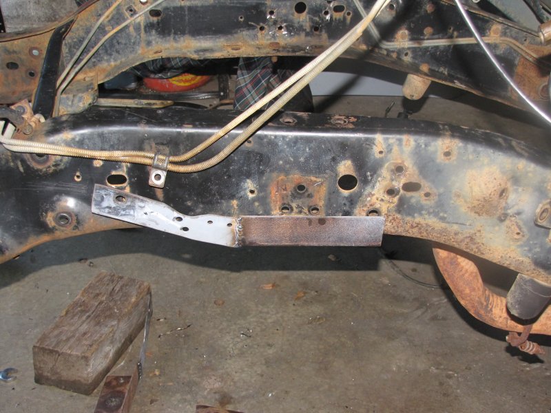

Here is a picture of the bracket I made hanging in place. It isn't bolted up, but...

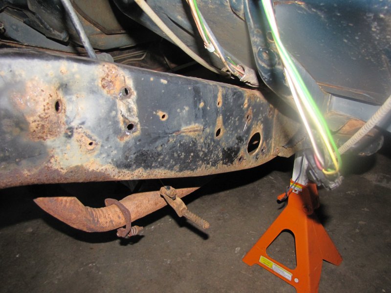

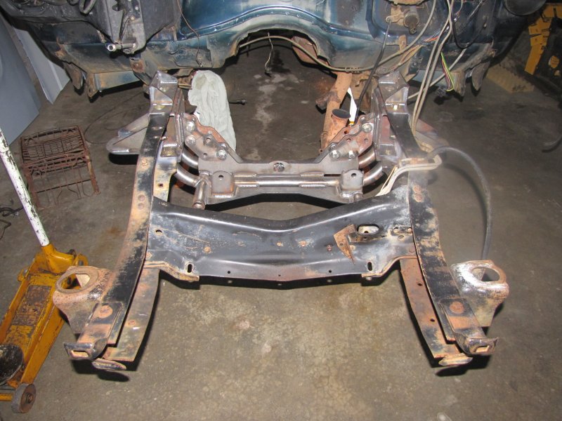

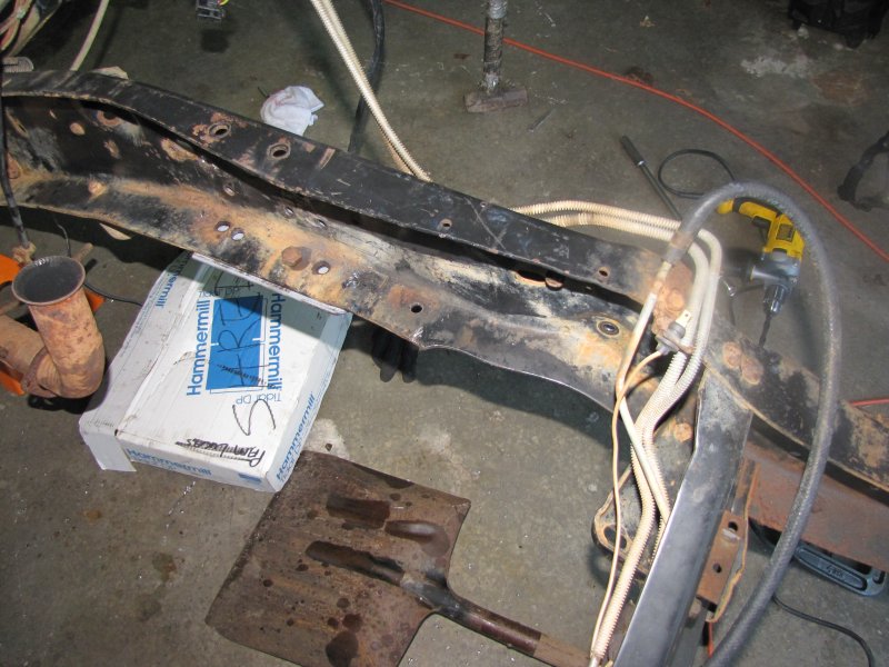

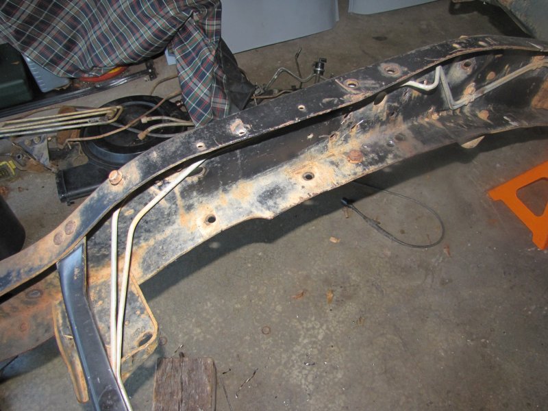

Saturday, Oct 15th 2011:
Using the upper Porterbuilt brackets as a guide and with some major measuring to ensure I got it all in right, drilled the holes for the upper control arm/bag bracket. Top pic is the drivers side before drilling the holes, bottom pic is the passenger side after drilling the holes.
Pulled out the grinder with a cut-off wheel and started on the shock mounts and rear leaf hangers and got them removed, got one bumpstop removed and found the other side was spinning free so it need to be sawzalled off.
The proceeded to grind the rivets for the front leaf brackets (I am keeping the 4x4 core support mount). You can see they are gone on the top pic
Mocked up the crossmember/engine mount to frame brace and found there were several bolts missing. Put in a call to Porterbuilt to get the missing hardware, but I am close. I need the hardware to finish up the front to put it on the ground. At this time I am 20 bolts from having it all bolted in short of the control arms and shock mounts.

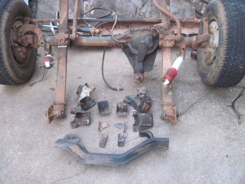

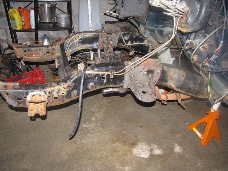

Want to know what it take to convert the front of a 4x4 to a 4x2? There are 40 rivets and ~22 bolts that have to be removed to eliminate the 4x4 specific components

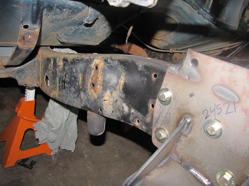

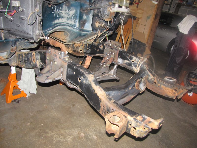

Sunday, Oct 6th, 2011:
Got the shock mounts bolted up, got the shafts for the RideTech lower control arms removing and bolted up to the Drop member, got the passenger side RideTech upper arm bolted up, Drivers side will require the 4x4 style brake line to be either re-bent or replaced with the 4x2 style.
Better pictures coming....
