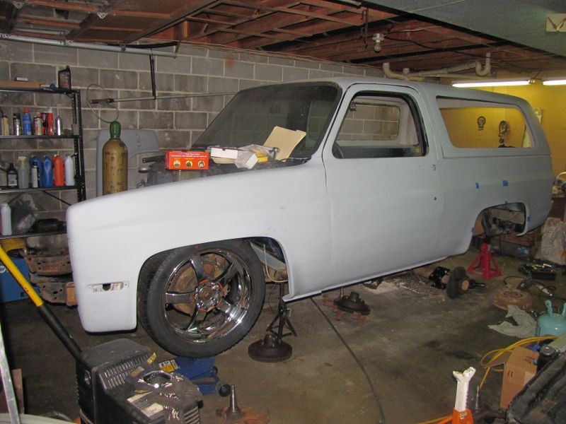

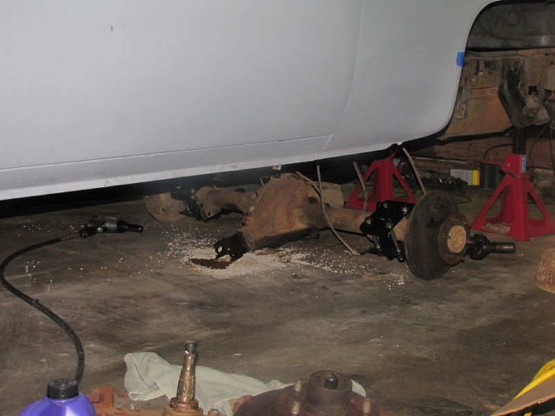

Monday, June 17th, 2013: With the R10 in the shop getting turbos installed I took the opportunity to scrounge up some used spindles and brakes and mount them to the truck to get the ride height set so I can get the rear brackets made so I can get this thing back rolling and moving forward..  This won't be a slammed truck, it is going to be setup to be driving and if in the circumstance that my wife has a bag blow out, it will drop down to the bumpstop and she will be able to still drive it albeit slow to her destination...
Right now it has the stock 4x4 rearend and 6 bolt rims on the back I plan to get the 2wd rearend over and mount everything up, or find the 2wd 10 bolt axle and switch them out, but for now the airbar is setup on the 4x4 rearend, here it is...

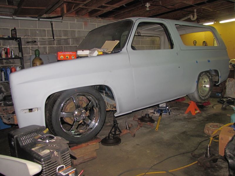

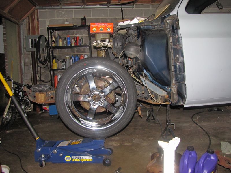

Sunday, June 23rd, 2013: After unsuccessfully finding a 10 bolt and not wanting to drive to my brother shop I decided to just pull the 12 bolt axles out of my 2WD Jimmy.  Pulled them out and then swapped them into the 12 bolt.  Generally I haven't had issues with this (it only works on 88-91 30 spline 10 bolts) but this time I had to polish off the ends to get the c-clips in.  Now I have 12 bolt 5 lug axles in my 10 bolt.  After getting the 6 lug 4x4 axle converted to 5 lug I setup the Blazer to be level front to back as I want it level while driving.  I then set out to sort the rear axle clearance as far as drop goes along with how much of a C-notch I need.  In the below picture the front tire will go up 1" for parking lot cruising and when at ride height I plan to raise the rear about 2" and the front about 3".  Next step is to set up everything at ride height and get the front link brackets made.

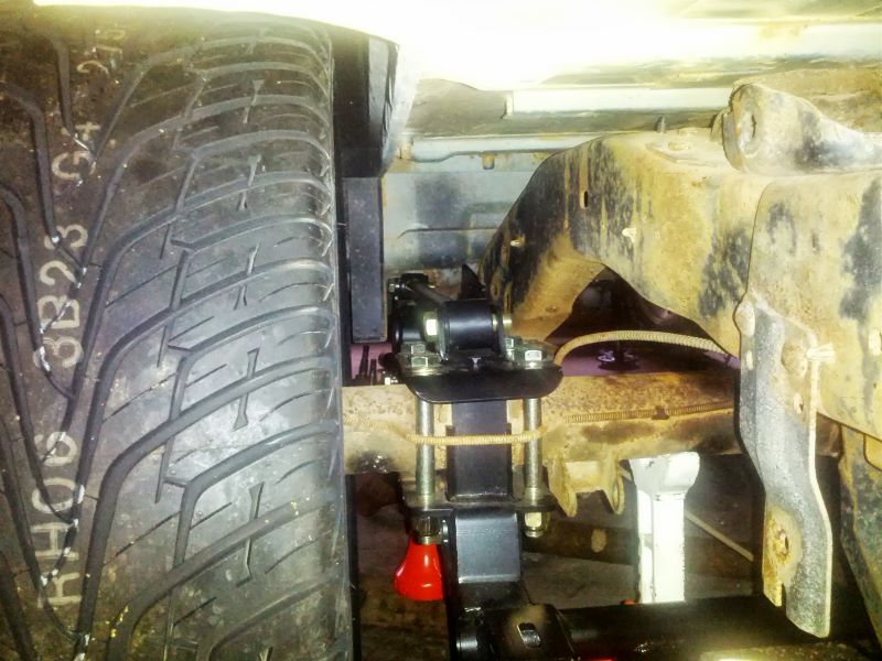

Wednesday, July 3rd, 2013: Playing with the Ridetech Airbar and not going to be able to get it as low as I want it.  Trying to come up with a way to use some of what I have to work without recreating the whole setup.  Doesn't look promising...
This is the rear suspension with the bars level, and the truck about 3" too high for ride height..  You can tell the 78-up dropped floor is in the way of the top bar.  Will be looking for alternative mounting today.

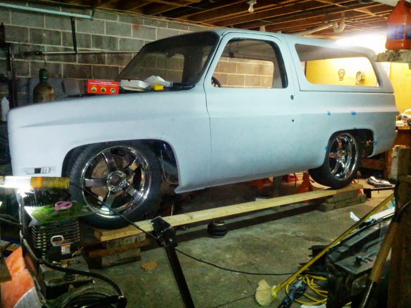

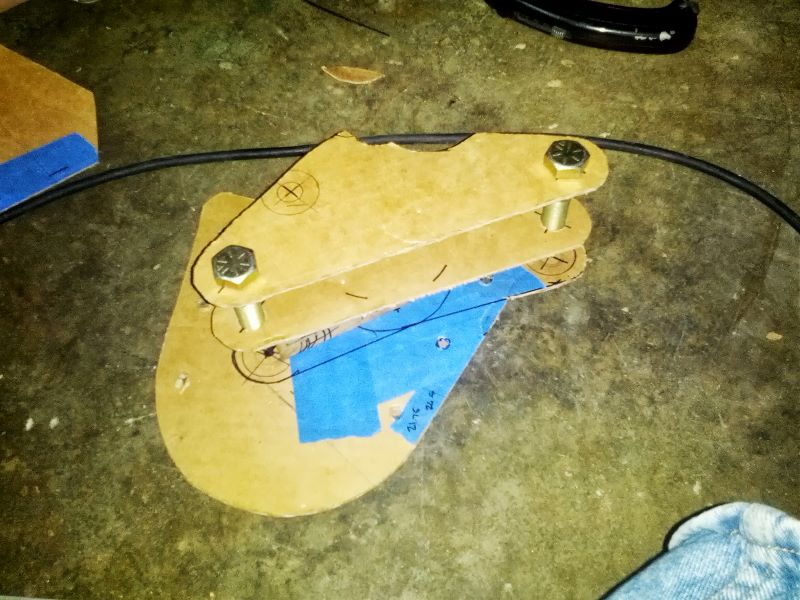

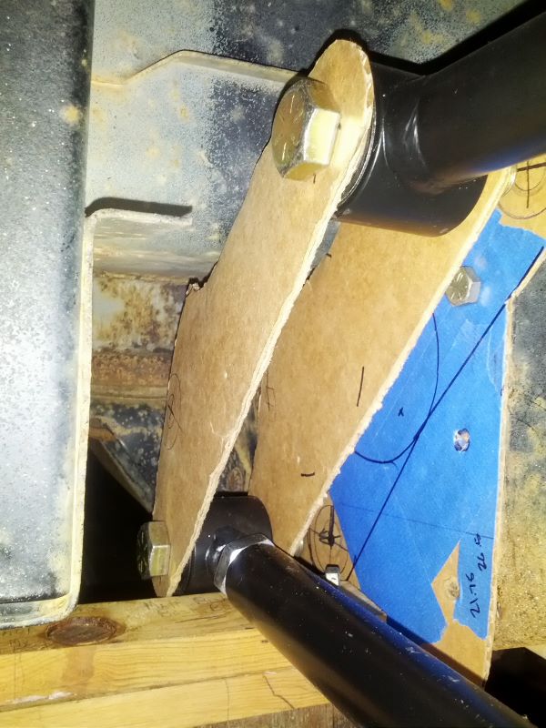

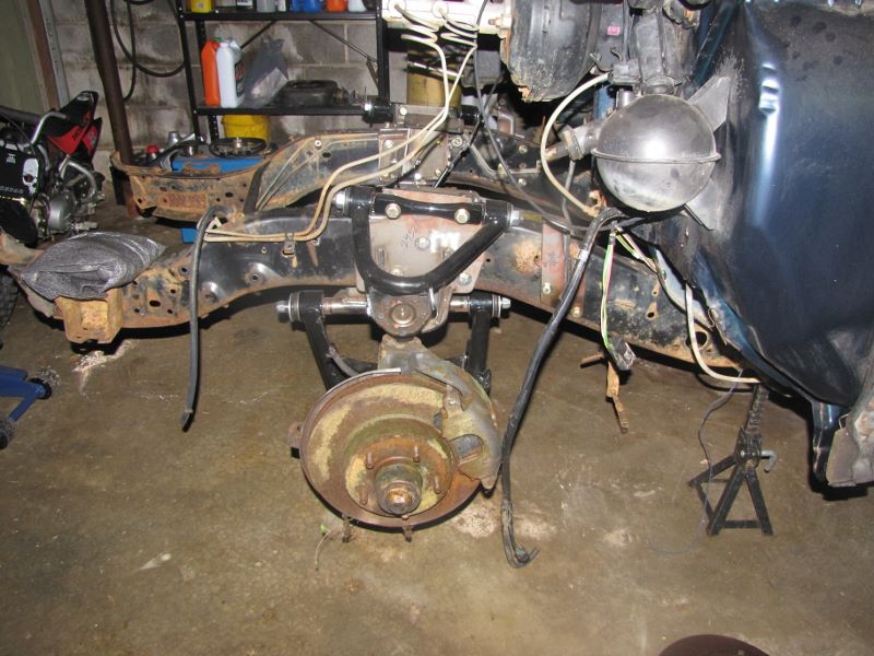

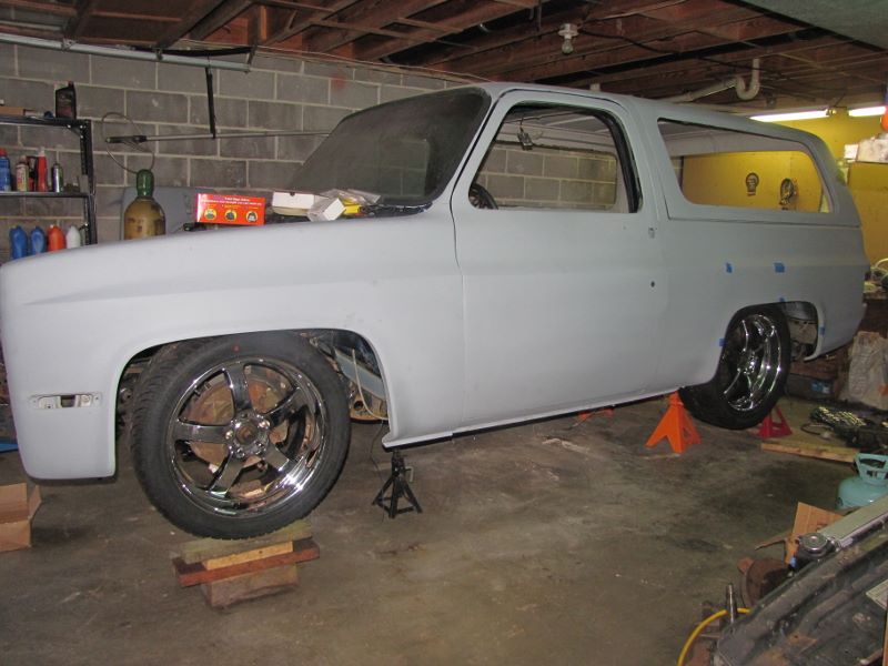

Saturday, July 6th, 2013: Started working on the rear suspension and designing the 4 link front mounts.  Played around with the height for a while and finally decided on what would be the cruise height shown below.  Ride height will be a little higher in the front and back to get good suspension travel.  I setup the link to be able to clear at this height so moving it down would be simple.
Here are the templates I made, just need to pick up some steel and get them cut and welded.
Here is the view from the back sitting much lower than above.
This is going to be cruise height.
This will be REALLY close to ride height:
This is why it is going to be cruise height...
After all of this, I have decided to redesign the rear suspension completely as all the parts I have from Ridetech for a pickup will end up being cut up, so I might as well make all of this fit like I want it.  Bags will be in the rear, shocks will be in the front.  The panhard is going to be MUCH longer.  Stay tuned...

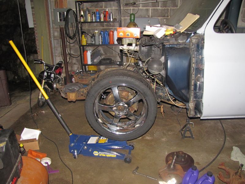

Sunday, July 7th, 2013: Talked Live85 into bringing his truck over and mounting my rims up on his truck for fitment and ride height guides.  In this pic his front rocker is 9.5" off the ground, the rear was 10.25" off the ground

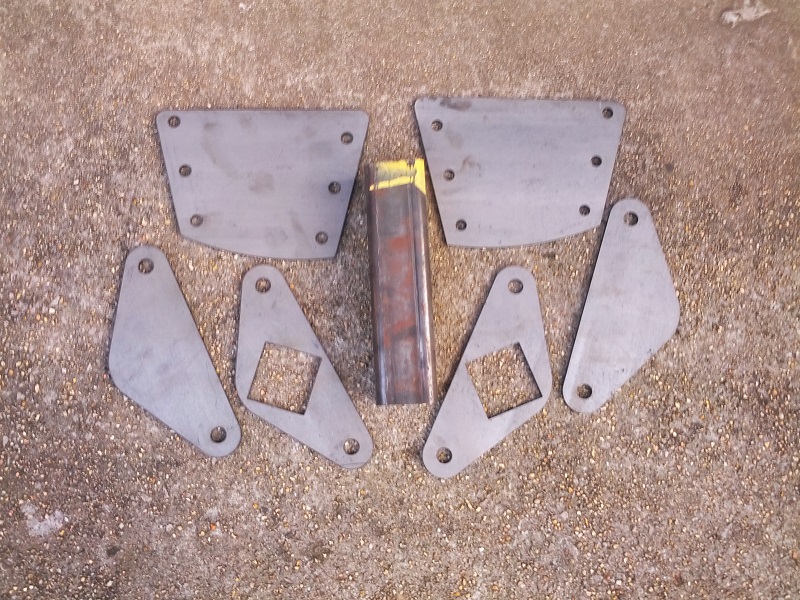

Wednesday, August 28th, 2013:  Finally received the brackets I designed for the rear suspension and that I had someone laser cut.  They got them before I left on vacation.

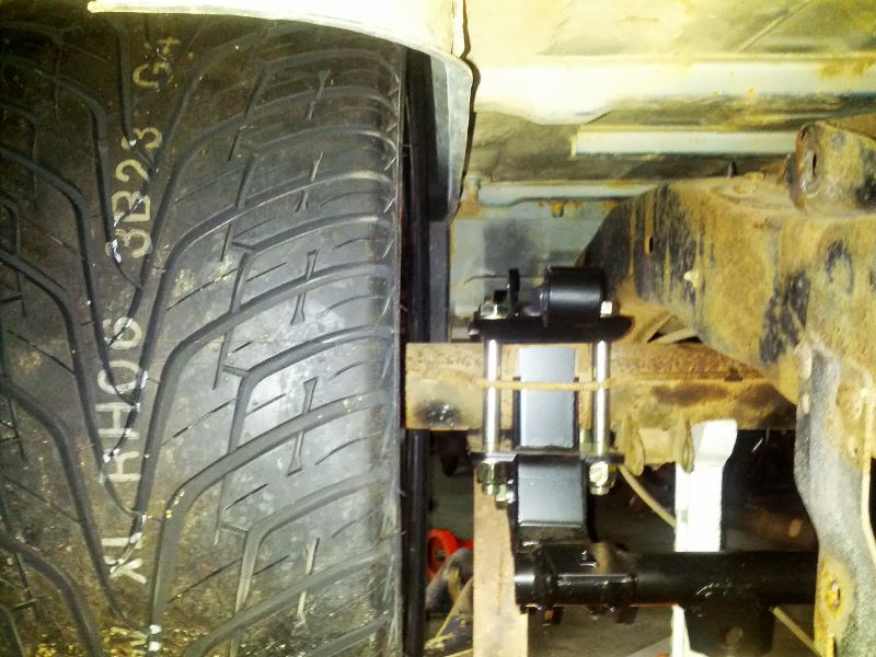

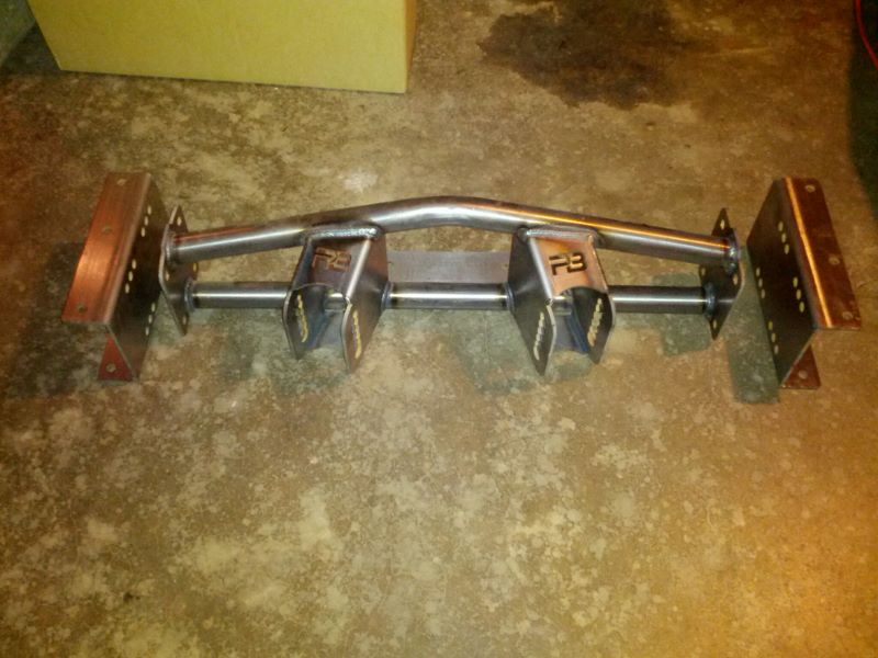

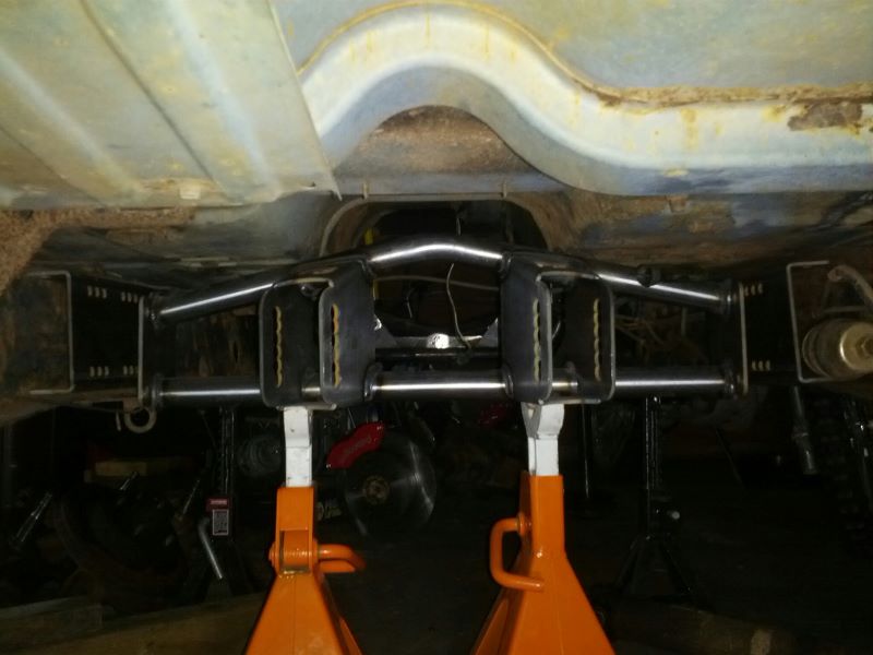

Tuesday May 20th, 2014: Ordered a rear trailing arm setup from Porterbuilt.
Tuesday July 15th, 2014: Porterbuilt parts showed up today.  Going to be attempting to get it in and under the Blazer.  I put the crossmember in place just to get an eyeball on it...

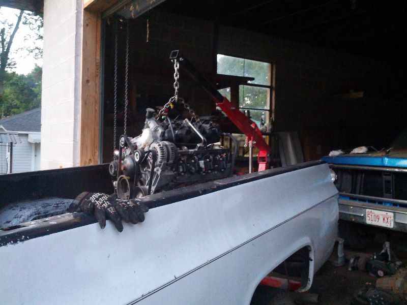

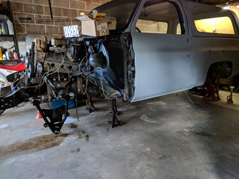

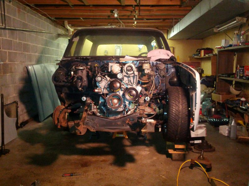

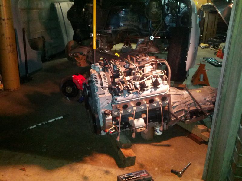

Monday, July 28th, 2014: In order to get the Crossmember in the correct location I needed to get the engine and trans set in the truck.  So I went to my other garage and picked it up with the help of my Brother.
He couldn't stay but helped me get the motor and trans connected and I spent the rest of the night wrestling it in between the frame rails. Unfortunately I stopped right around 1pm to go to bed and didn't get it bolted up.

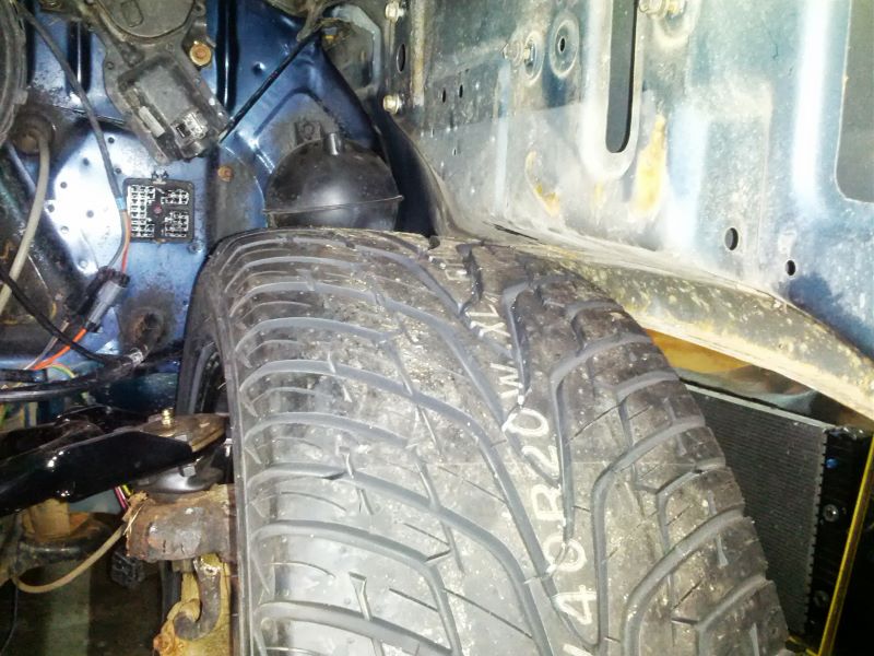

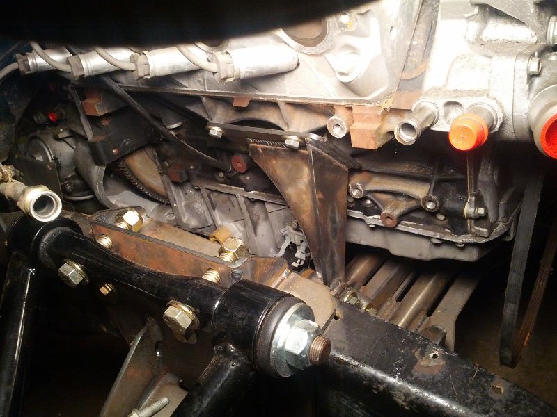

Tuesday, July 29th, 2014: After getting home I attempted to install the motor mounts and found that they were too tall.  Call Porterbuilt and talked with him about replacements.

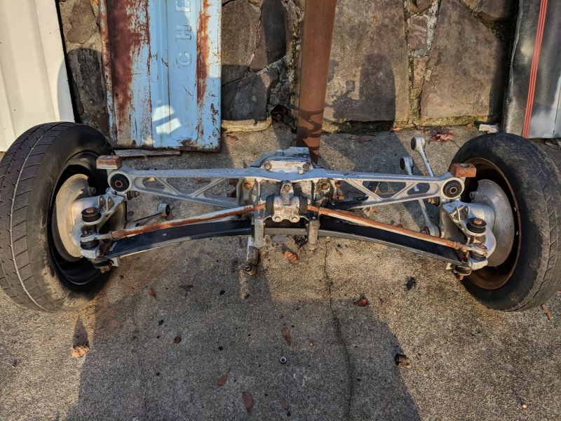

During this time I considered completing the other possibilities: Building a bridge/notch for use with either the PBfab Trailing Arm setup and/or the Ridetch 4 link.  But at this time the only option for these were Air Ride.  And I am really over that for a driver.  I looked at several options and talked to a number of companies.   I decided I wanted to go with Coilovers and looked at QA1 and RideTech setup, but Still no one had an answer for a Blazer.  During the drives home in my truck I was constantly parking in front of the 1986 Corvette rearend I acquired back in March of 2007.  And one day it just hit me,  I should just try and mount that under the Blazer.
Friday, September 21st, 2018: After doing some research I found FlatOut Engineering makes a kit for the 67-72 Pickups, which based on the crossmembers I used to chop and sell will fit a 73-87.  So I called them and during the conversation I told him what I was wanting to do and he was interested.  He send me some forms to fill out and that weekend I took some pictures and measurements and sent to him to review.  He also told me some places to check for front suspensions

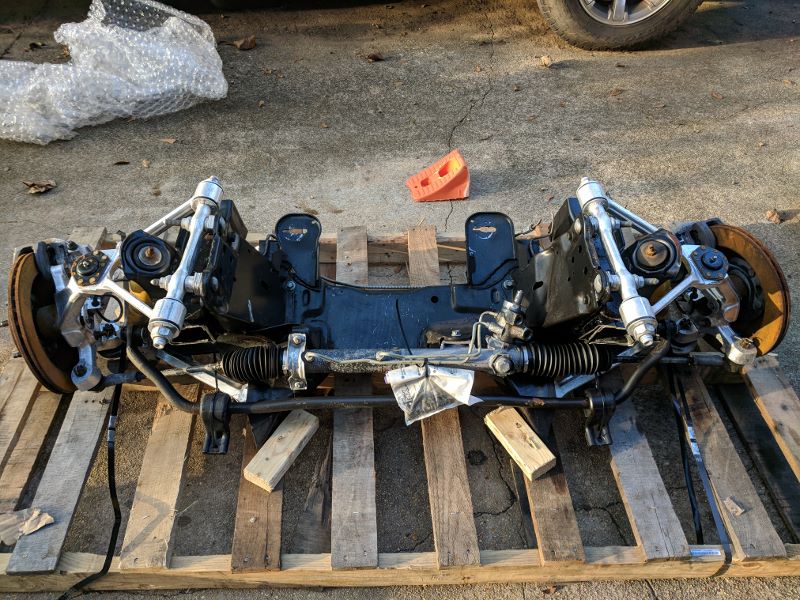

Monday, September 24th, 2018: I found a Ebay listing from one of the reputable companies he suggested and I placed an offer and I made the purchase for a 1992 Corvette IFS hub to hub.
Monday, September 28th, 2018: I called FlatOut Engineering and told him I would have to front coming and would give him a call on Thursday October the 4th.
Wednesday, October 3rd, 2018: The front Corvette IFS was delivered this afternoon.
