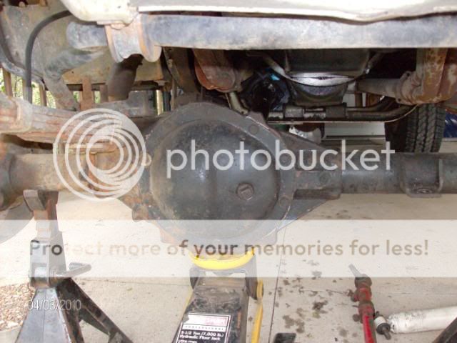

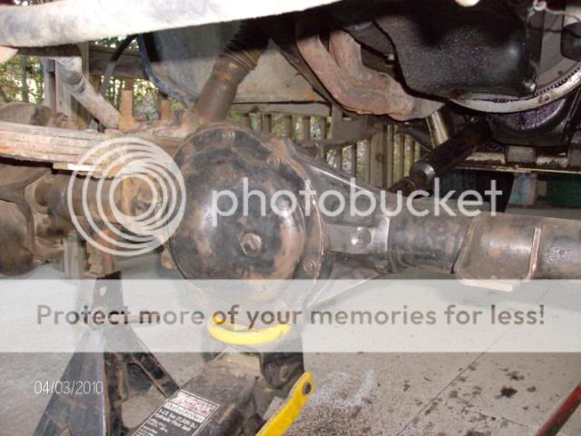

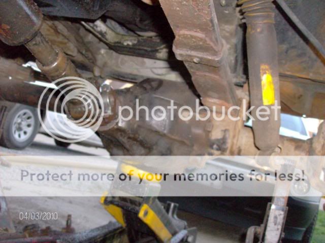

This my front Diff. I can't find any markings on it no where, except on the Passenger side of the case. It says K88 and some dos going in a circle with a Triangle point at 12:00 o'clock. Most of the corporate stuff is covered in GM logos. This one is not. And do they make a pinion seal? looks like I'm loosing some lube from the back side where the Drive shaft connects.

That is a 10 bolt. A 44 had a raised boss around the fill plug, and the side of the cover the bolts are all parallel to each other, only the top, and bottom have a round shape to the bolt pattern. It doesn't have GM stuff on it because they were made by American Axle Manufacturing.

Thanks Guy's. Wishful thinking didn't hurt much..LOL..I'm still having a Ball messing with this old Truck, and learning a lot along the way. How about the pinion seal? do I need to drop the drive shaft and pull the pinion out?

Don't get down on yourself Rob...there is little to no difference between a 44 and a 10B.  Yep, driveshaft has to come out.  Pinion nut has to come out too.  Mark the nut and have an idea of how many times you spin the nut off... if you under or overtorque the nut you'll take out the pinion bearing.

The pinion itself does not need to come out. Only the shaft and the nut. It would be a good idea to have the torque specs for the pinion nut. Then counting the turns won't be needed.
