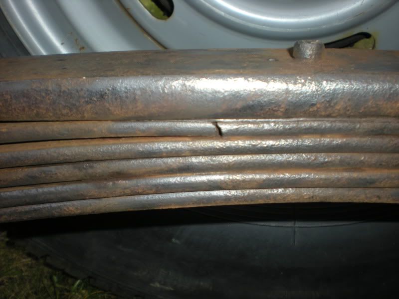

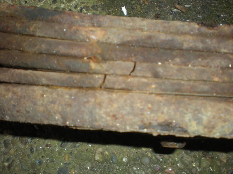

Well i found something i wish i never did today when cleaning up the rear leafs,cracked leafs on each side which for me is a big decider on whether to carry on with the project.
Being in the UK plays a big part in this as its gonna cost an absolute fortune to find a pair for a reasonable price.
I wish there was another option...cheap coilover setup etc..?
Dave

Go to your wrecker, or towing company, see if you can find a leaf sprung van, buy the springs, put 3 leafs out of the van springs in to replace 2 of yours.

I'd say if thats the only crack on the leafs remove the bottom two leave the over load and add air shocks to bring back the load capacity
You read my mind big10..did exactly that and new shocks on order... ;D

Many thanks for your kind offer,i would have snapped those up in a second even though the shipping would have set me back a month.
I managed to remove 2 leafs from each side and relocated the clamps that were fixed to the broken leafs...with this completed i found my next hurdle which is a severely cracked brake drum,lord knows how this came about but im glad i found it..?...i love the way this truck is creating work for me.
