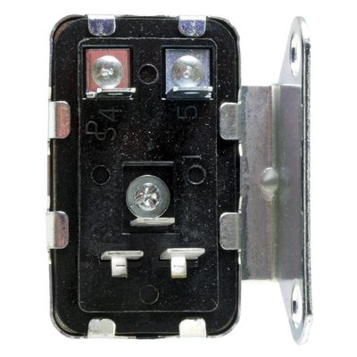

It sure sounds like the relay has stuck open. If the blower doesn't work after you tap on it, then it's probably not closing to send the signal to the resistors.
Here's a pic of the resistors
Which fan speed you choose determines which resistor gets "used" by the voltage coming from the relay. So the reduced voltage can then travel on to the blower motor
Since you have B+ voltage at the red wire going into the relay,I think Irish is right- it sounds like the relay is bad.
  New relay costs @ $16.00.

Thanks Everyone, but no luck - I replaced the relay (wow, these are getting hard to come by locally) and removed/inspected/cleaned the resistor, but that has not helped.  Is it safe to say that the only thing left is the actual HVAC/heater control module in the interior (is there a name to this HVAC control module)?  I didn't find any bad fuses either.  Below are pictures from my truck.  Anyone have ideas?

Bear with me guys, here's what I found:
1-a direct wiring from relay to motor doesn't work (regardless of interior switch setting)
2-confirmed again that the red wire is B+ (always hot)
3-There's 5 pins on the relay, so red is B+, purple goes from relay to motor, black is ground (?), and that leaves 2 more wires that I assume go to the resistor?  If I have power going to this brand new relay, do I have a defective relay or is the interior controls causing a problem where even in the off state (for the controls) - the fan would still not run with ignition key on?
