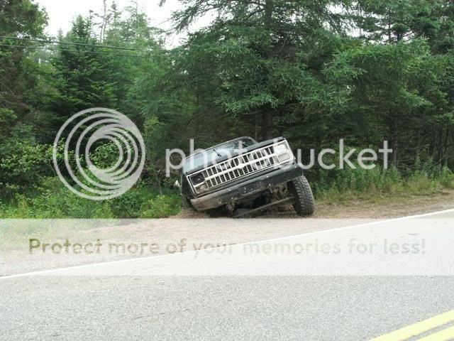

yea i smashed an 87 with a 3" body and broke the back two body mount bolts off, and i was planing on running 345/75/16's
