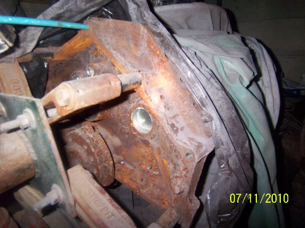

That is what I'm making out of his description. Like Swims said, I have several blocks drilled & tapped, but the tranny having the hole is very odd...seems to me I had a Blue stickshift bell housing (maybe an iron duke H-body) maybe it was a truck, that had the top hole, who knows?  Greatdane, The one with the pencil in it? Lorne

Mine looks like the top one! My original trans had the top bolt hole?! But this one doesnt? I think I am OK though!
