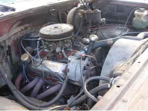

Do not have a lot of before pics but plenty of afters

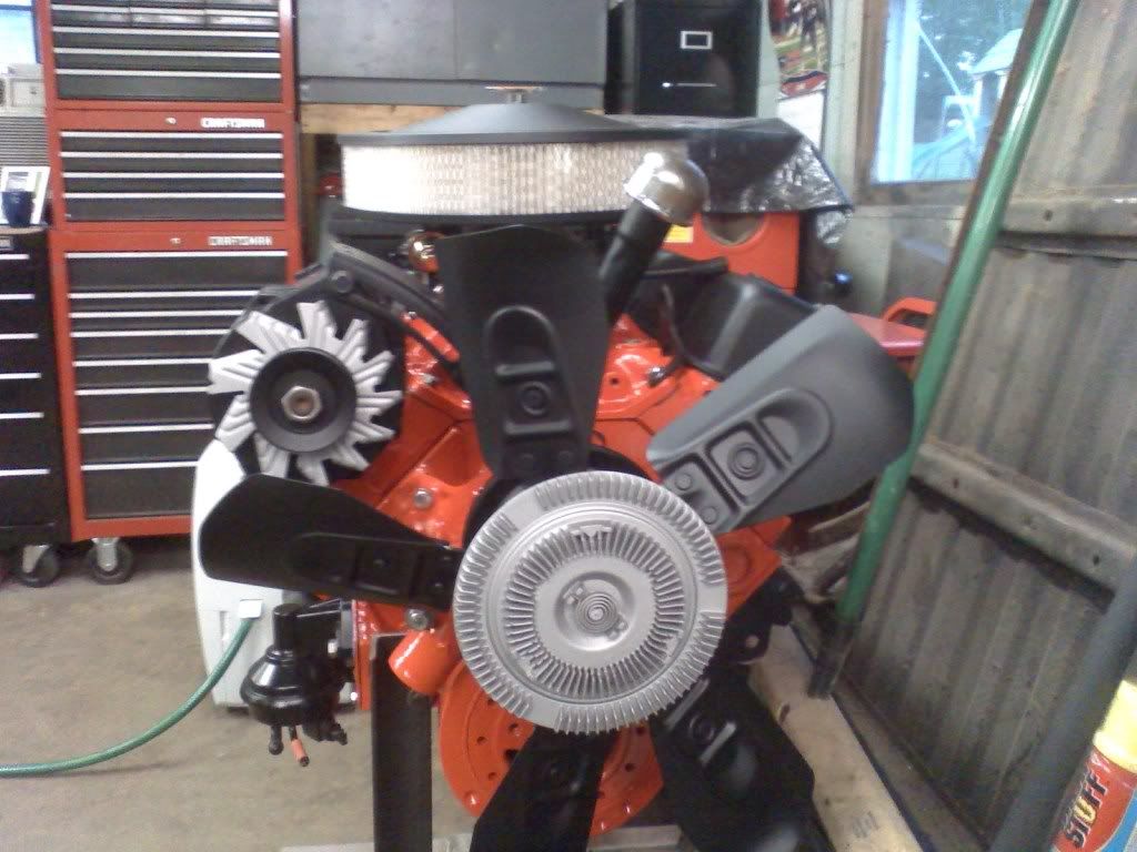

here is the engine
and in the background

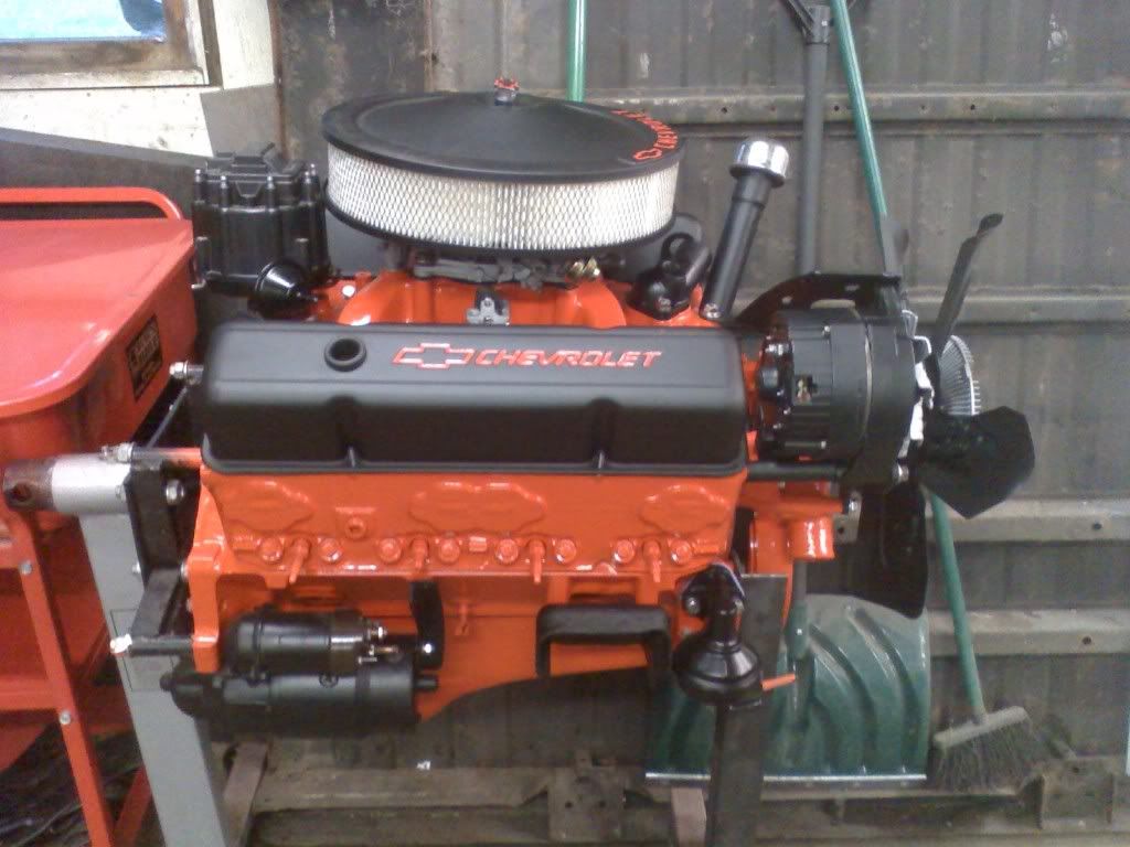

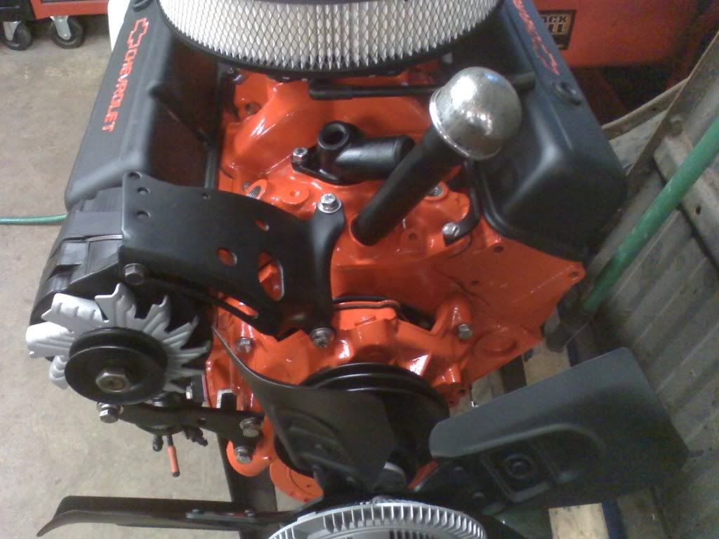

And the after
Went through the whole motor, rebuilt the startor, alternator, and powersteering pump
The only thing I did not do my self is the carb that went out now I'm waiting on the kit to rebuild the A/c compressor

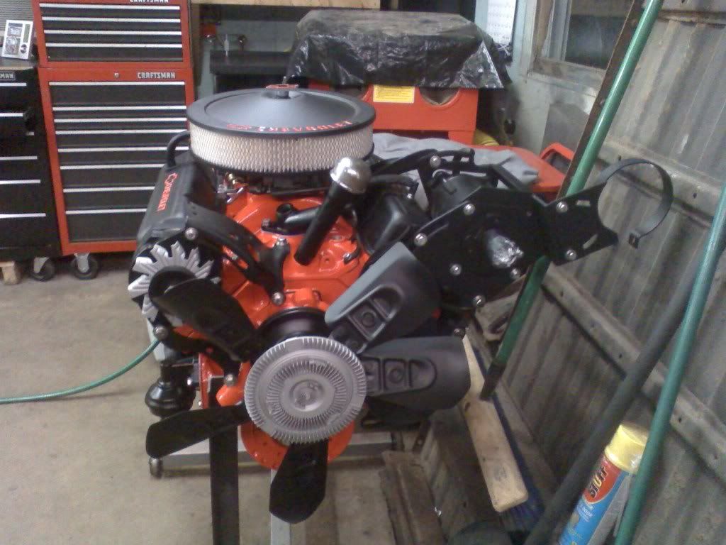

A/c compressor still needs to be rebuilt but just wanted to see it on.... the bracket mounted to it is for the plow pump

What a difference!!  I like the look, and the old school oil filler in the intake.  I'm also not a fan of chrome, paint shows much more detail so your mill is aces with me.

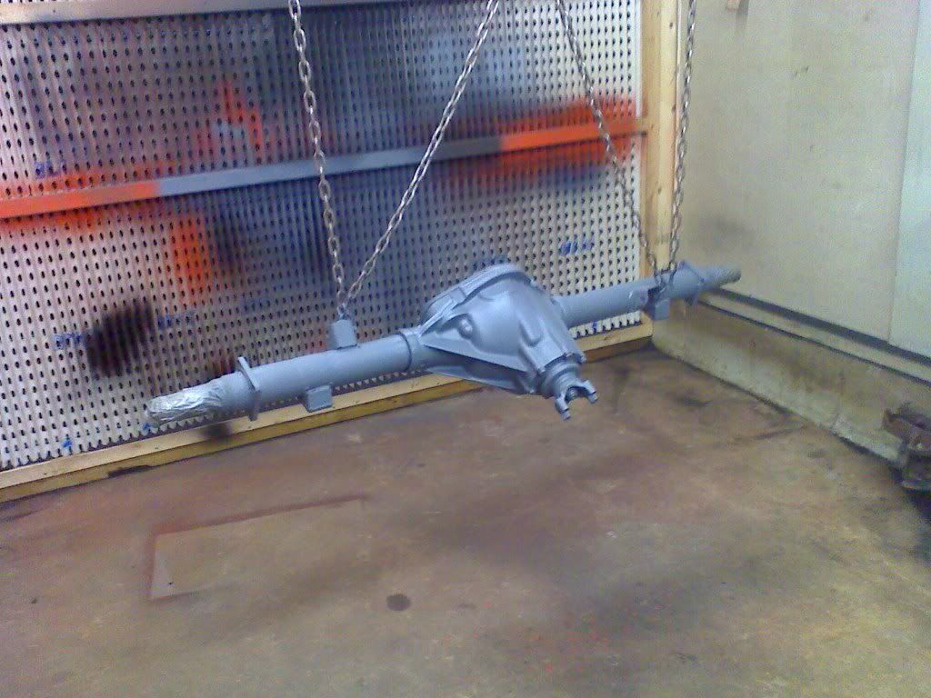

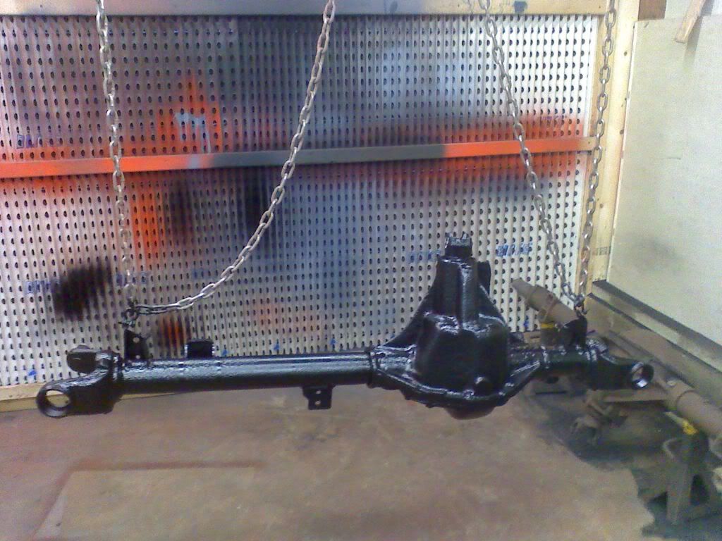

when i got it the front d44 was toast so I found a good Dana 60 to go with the GM14 bolt
The 60
And 14 Bolt primer only
Next step is to sand blast frame, rebuild the SM465 and NP205 and get the drivetrain done

Way awesome!
So, why does it look like your fan blades have uneven spacing?
Re: so here is my 77 K20
« Reply #6 on: July 15, 2010, 02:39:58 pm »
All of the factory fans do.

« Reply #7 on: July 15, 2010, 05:18:45 pm »
have no idea what the deal is with the fan, but Ive not seen to many that do have even spacing kinda weird
I havent seen too many factory fans. What is the reason for it?

« Reply #9 on: July 16, 2010, 03:21:32 pm »
as I understand it it makes less noise with the blades uneven like that
