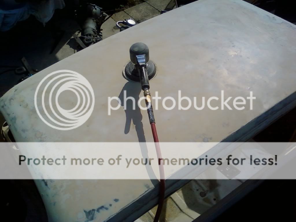

Got some primer on cab and wanted to post up. Next week the doors and fenders will be done. Then putting in a 350/TH400 in and starting the rewiring process.
