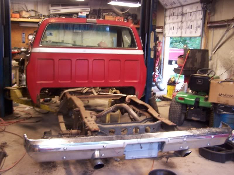

Got it on the lift, and removed the transmission. Removed the transfer case first. Then cut the exhaust out, and finally dropped the tranny.

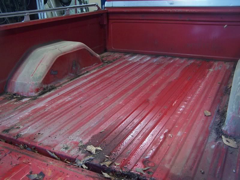

Then went at the bed. It had a plastic liner in it. My worst enemy! Lucky for me though the bed was clean under it!
Next was the bolts holding the bed. I held them down with a board while my Dad tried to get the nuts off. Most all of them spun, so we had to torch the bolts off.

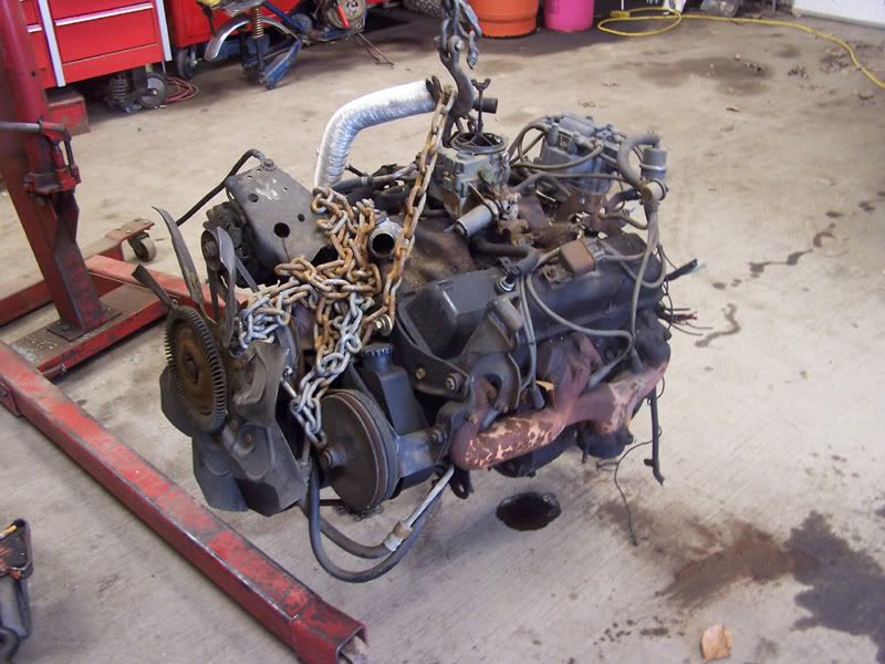

Pulled the engine next.

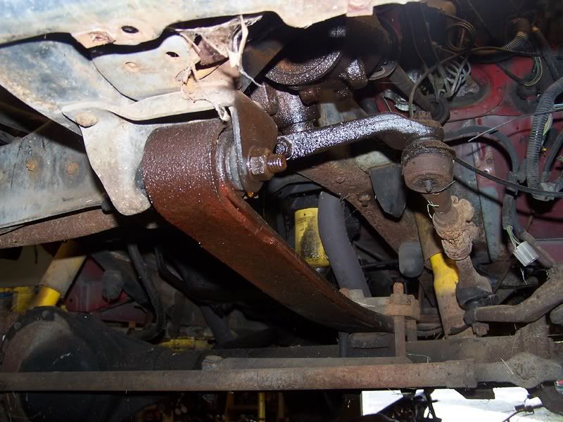

Next some penetrating oil on the leaf spring bolts. I swapped the front leafs, and swapped the entire rear axle.
Settled for blocks until I can get leafs. I'm probably going to end up doing a shackle flip. That'll be the same time I go 3/4 ton.

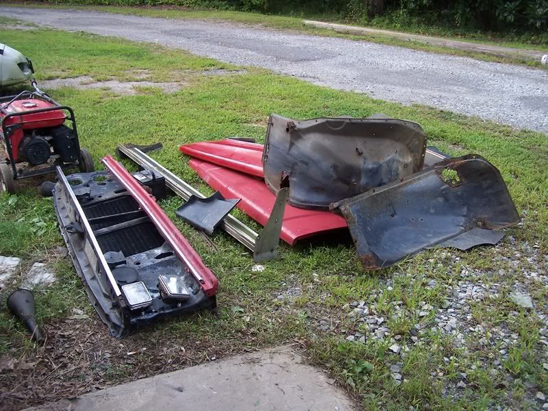

All the panels I took out (Anybody need anything?)

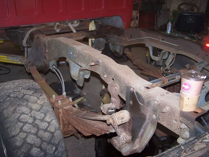

The frame after sealing. I had wire wheeled it before. Still needs painted.
My truck grew another pedal. I mounted the clutch pedal, and mounted the bell crank arm to the frame. It was off a Blazer. I hammered out the old rivets, and bolted it to the frame. Chevrolet was nice enough to put the holes in the frame already. Made it easier for both of us.
