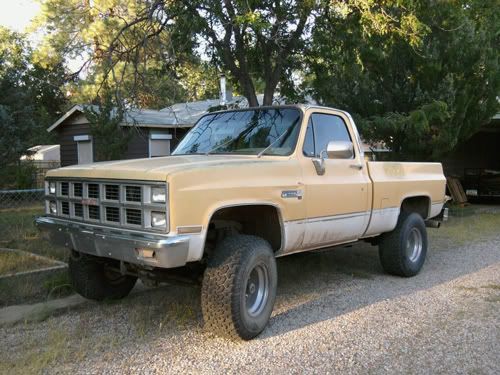

I just bought this GMC truck as a project for me & my son, we have 3 years until he can drive it...good thing.
1982 GMC K1500 Sierra Classic 383 Stroker 4" Rough Country Lift
