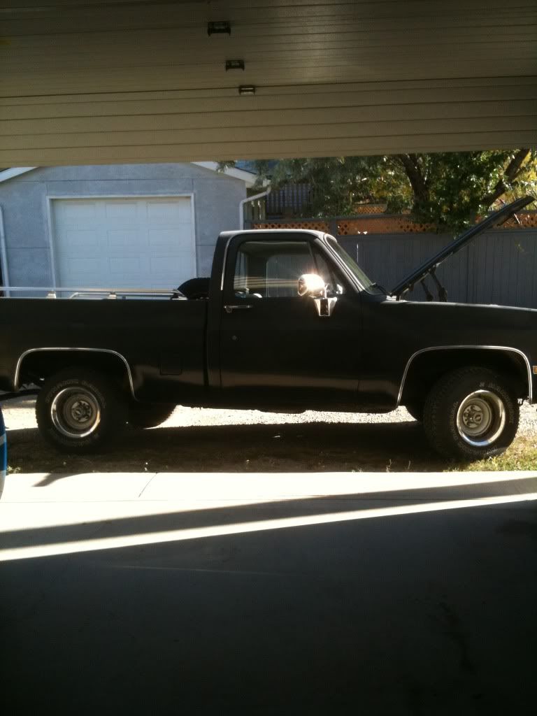

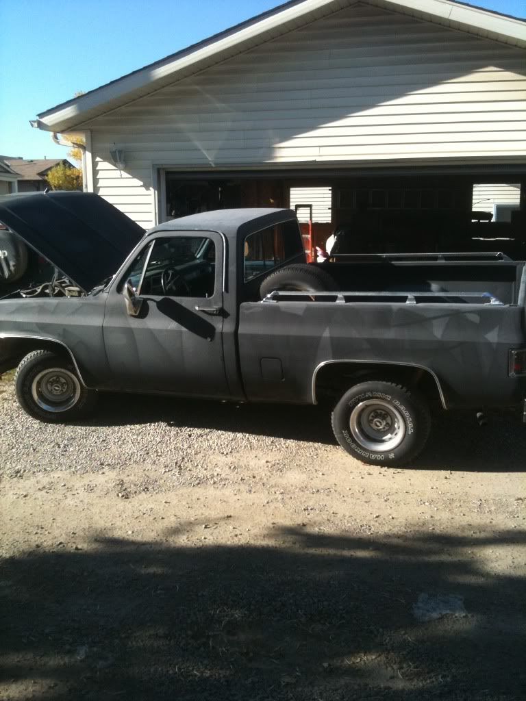

I recently bought a 86 short box fleet side that i am looking to restore. Most of the body work has already been done just has a small amount of rust behind the rear wheels. Rockers and cab corners have already been replaced.
I am looking for advice about a few things so i will blast away here and hope you guys can chime in.
For the rust should a guy replace the entire box side or are patch panels okay.
I want to lower the truck 3-4 what kit is the best or at least what are the pros and cons between them.
Trying to decide if i want to put a healthy carb small block or get something newer and fuel injected and input would be great.
Are all interior pieces available? i can find door panels headliners dash pads and such but what about the other plastic pieces my interior is blue and i would like a black interior i know i can dye the pieces but i have a couple that need to be replaced like the piece by your shoulder where the seat belt mounts.
I know everyone likes pictures so i have included pictures of the truck.

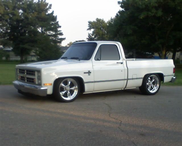

Found this picture on another site. This is the look i am going for can anyone give me clues as to what the drop is on this truck.
Also what the wheels are and maybe a guess at the size 18"s?
Is there anyone that could photo shop this pic the same color as my car?

« Reply #8 on: October 21, 2010, 04:19:39 pm »
Looks like 18's in front 20's in back

« Reply #9 on: October 21, 2010, 05:45:02 pm »
I saw the white truck somewhere on the web and it said it was a 6 front 8 back drop and the wheels are american racing torq thrust 2's and were 20x8 front and 20x10 rear which is what i want to put on mine

« Reply #10 on: October 21, 2010, 05:58:51 pm »
Looks like the same size rims front and back
Thanks thats a big help. If a guy wants to do that much of a drop anyone have suggestions on a kit or parts to use?
Re: 86 short box advice needed
« Reply #12 on: October 21, 2010, 08:25:00 pm »
Flip the rear axle, use lowering spindles and springs.
