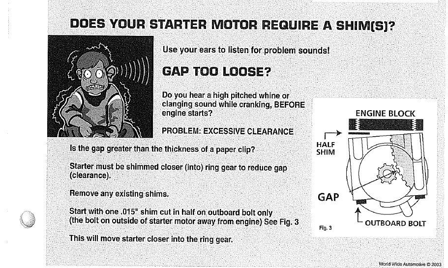

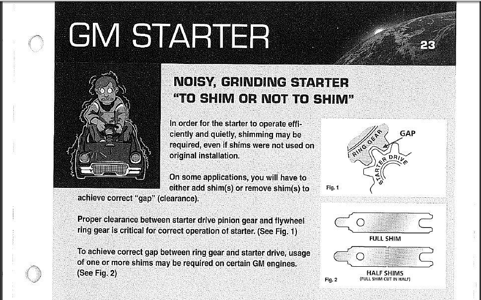

Re: starter woes
« Reply #11 on: October 28, 2010, 10:08:11 pm »
Re: starter woes
« Reply #12 on: October 28, 2010, 10:15:30 pm »
I scanned these a while back. I thought Chris put the in the tech section but I didn't see them.

I can't see them on my phone! :( I will not be able to get to a actual computer for atleast a week. :( you can email them too me if you want!?
