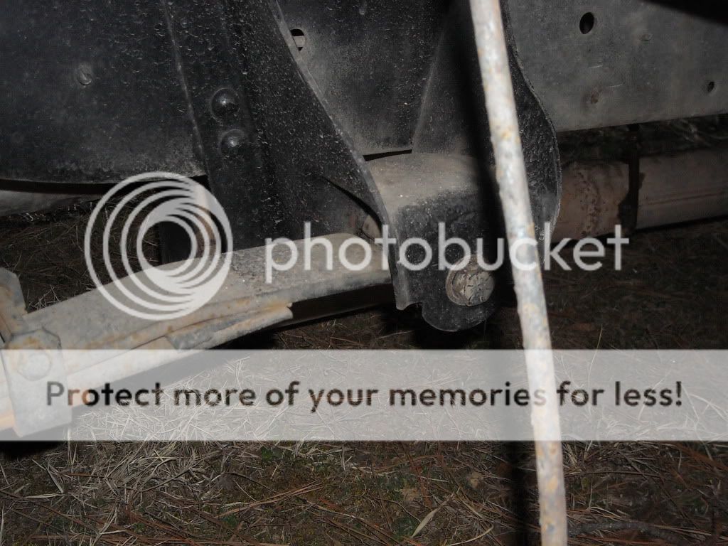

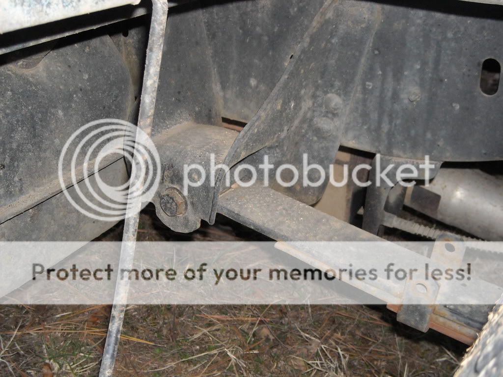

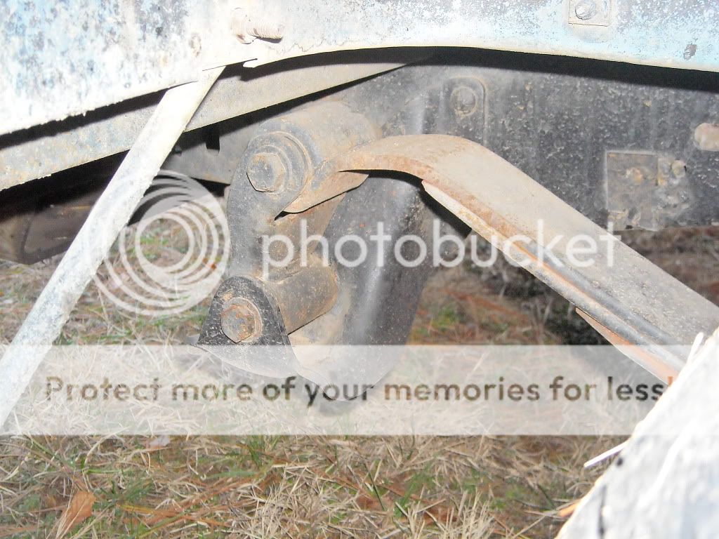

I bought my truck with the flip kit all ready done but it seems the back sit lower then the front by a little bit but also seems to sit a little lower on the passenger side. I took a look and this is what i found.
passenger side shackle(note the bend in the leaf)
here is the passenger hanger
and the driver hanger

if it is sitting lower on the pass side then it is def the bent main leaf. but there really is no bad thing about doing a flip, provided it is done correctly. i would def get the leaf replaced soon tho.
Re: flip kit probs?
« Reply #2 on: February 20, 2011, 06:25:23 pm »
Time for new springs. Make sure the shackles move freely.

Looks like both sides are bent....
Replace springs...

Missing a bolt on that last pic. The bracket for the leafs. Those springs look horrible!
     More than likely the shackle isn't moving and bent your leafs.
Re: flip kit probs?
« Reply #7 on: February 21, 2011, 06:36:45 pm »
Or someone overloaded the truck, or just took a torch to them.

I think this poor truck has lived many lives, looks like someone had a 5th wheel in the bed so weight was more then likely the cause but I'm not gonna rule out some shoddy lowering "tricks" lol.

It could have been overloaded, "or" the PO heated the springs to get more drop. Replace those and check your front springs too.
