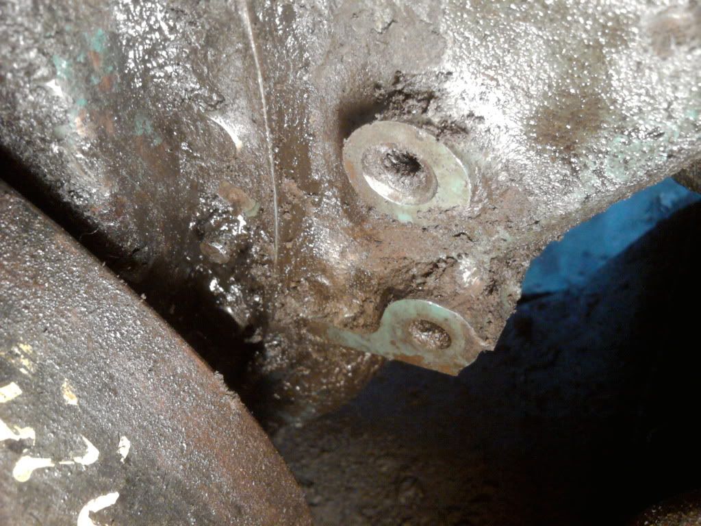

Went out and got a spectre brand timing tab "for chevy 350s". Removed my power steering pump and cleaned some of the grime away.
I don't see a spot for anything to bolt on, except for two small holes to the right. The spacing is off on these holes and don't line up with the tab. Ill try and get a pic.

should go under 2 of the bolts on your timing cover typically

Awesome, finally got it. So f''n cramped! I don't understand WHY ON EARTH the p/o took it off. Now I just need to time it...finally.
