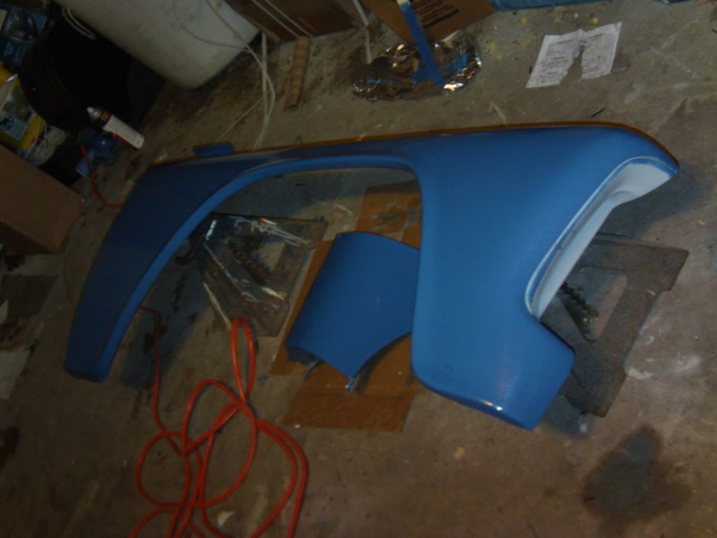

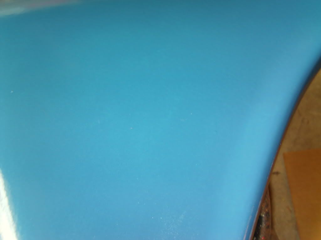

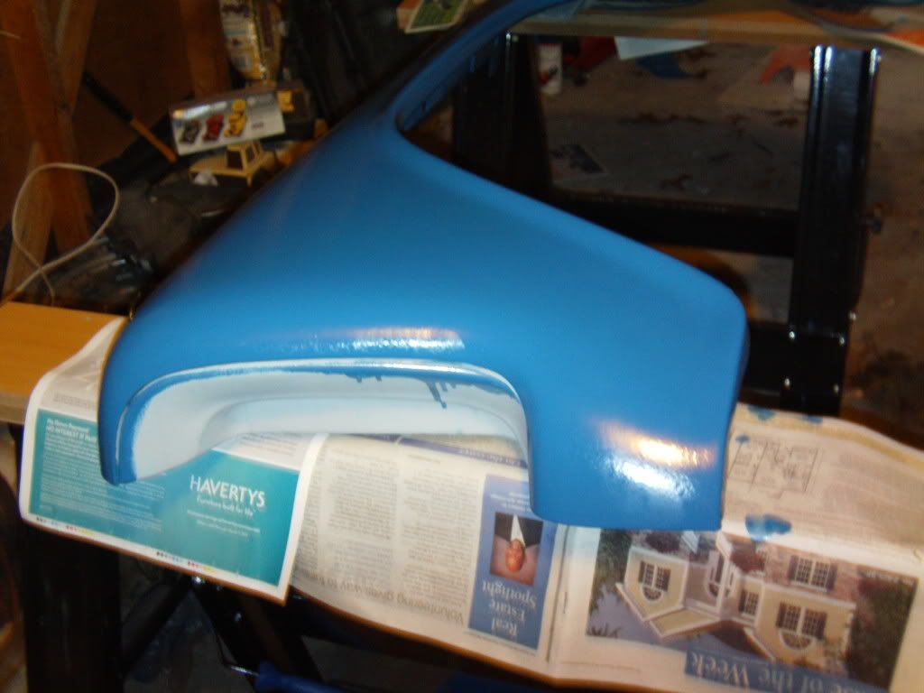

we are actually doing this method on my buddy's 66 long step and my 81 long bed... you dont have to sand between coats unless you get some serious trash/bugs on the panel... heres a link that we studied before we even started on the paint
http://www.rickwrench.com/index79master.htm?http://www.rickwrench.com/50dollarpaint.html
and heres some pics of the fenders that we've painted so far... it looks better than a Maaco job and should last longer
you can see its not a Concourse quality paint job but for a daily driver its pretty dang nice
