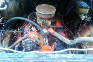

A couple pics... I'll take more soon and post on here

There is a ledge behind your alternator.  The top of the block post the numbers you find.  We should be able to tell you the original application for your engine...

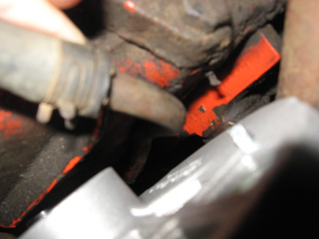

Diagram helped with seeing where it was found it real quick once I cleaned the grime off the face of the block. There was a VIN number of 1 9N521241 then under that in a bigger font was 040. To the far right, while looking at the numbers, was what I am sure is the EIN, but it only has 7 digits, V1OIOFL,  and that page you linked was showing 8 digits for the EIN. I am going to google it but if anyone gets to analyzing it before I can find it it'd be much appreciated.
typed identification
1 9N521241     V1OIOFL
             040

V1010fl comes up as a flint motor from october 10, a 69 327 block from a full size with a 2bbl.

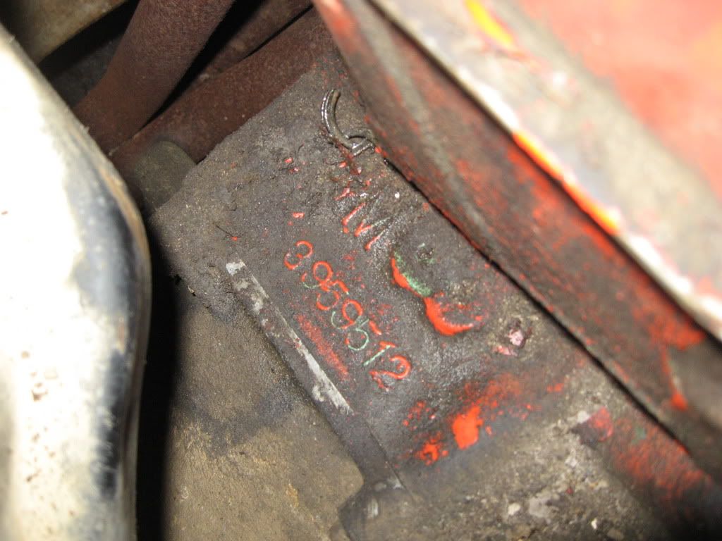

Here is the Casting Number I Just went and found, 3959512. Haven't been able to match it up to anything yet though.
And here is the best pic I could take of the partial VIN and EIN... it sucks I know but its a pain take a good one when that alternator is in the way.

That is a 1963-63 small journal 327.  250hp
x2

Yeah thats where I get confused though because the top of the block is stamped with "1968", to the right side of the "firing order", thats stamped in front of the carburetor. Then the casting number points to all the "9512" casting number blocks being a replacement block for all different types of engines. To be honest I am not familiar with the term "small journal" or "large journal" if you could tell me a bit more about what that means it might help me out a bit.
