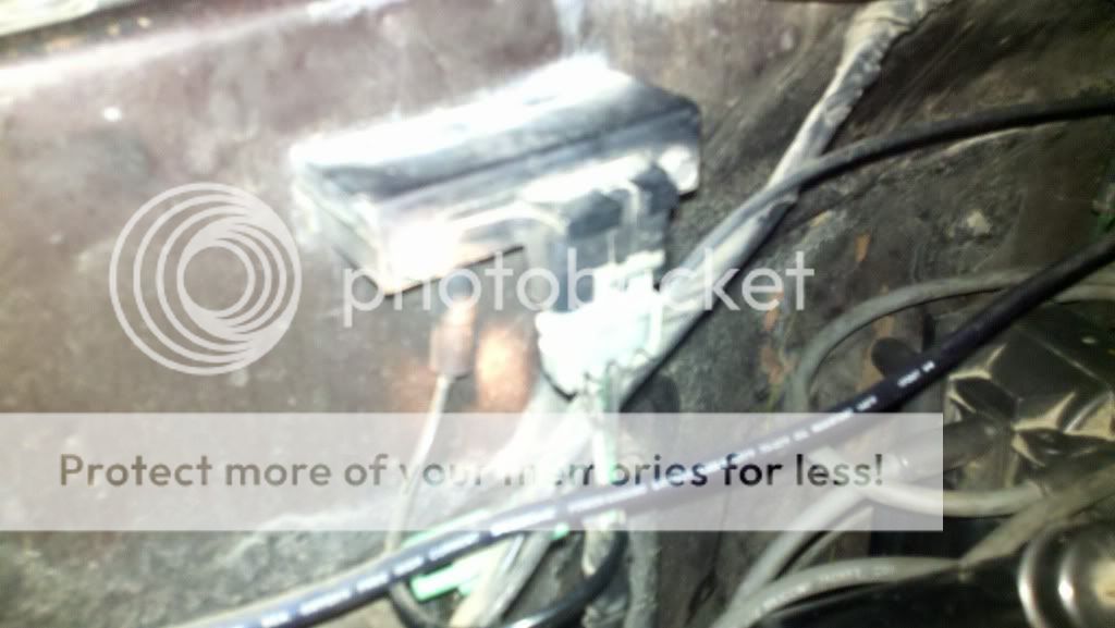

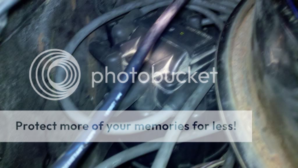

every distributor should have a vacuum advance right?, unless its like after market one?
my brother has the same truck and engine,on his dist. he has the vacuum advance, and he just purchase a new dist. and it came with it, so i wonder why on mine dont have that... what problems i would have if i dont have that?

Your timing doesn't look anywhere near close to me from thos pictures.Even if the rotor is point at #1 Cyl, it doesn't mean the engine is at tdc. The vac advance should be looking at you in the bottom picture, look around the base of the distributor and you'll probably find a little cut out for it. Head down to kragen and pick one up.

They sale the vac advance separate or I need to get a new dist.?

« Reply #14 on: April 30, 2011, 07:50:57 pm »
The sell them seperatly, about $10 if I remember right
