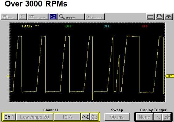

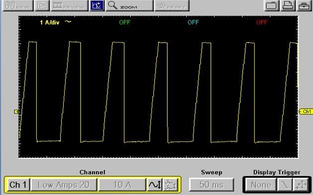

Actually they can get weak. In fact when you compare oem to aftermarket modules on an oscilloscope (especially Napa parts for some reason) and new vs old you will notice quite a difference in amperage when performing a current ramp test. With age the amperage can often fade and many ignition modules are designed to be current limiting as well.
In this example you can see a normal current ramp as the module is working
In the next example you can see the coil is firing multiple times most likely causing detonation. This is either caused by a faulty icm input or the icm breaking down.
I have some screen shots somewhere of a comparisson between two identical modules if I get some time I'll dig. Nevertheless, your most likely cause ignition secondary so check the plugs and wires next.
