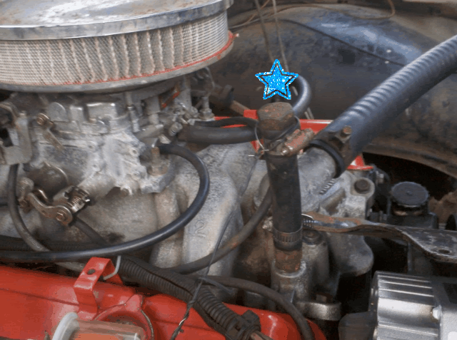

yes we tried timing it, and on top of the manifold it looks like they plugged one hole for a vacuum i think, i will show you a picture of what im talking about

Sorry for the blue star but below it is what i think is blocked off for some reason, is that the manifold vacuum?  so that is supposed to go to the vacuum advance?

is your heater hooked up?  if so, to what?  That should be a heater hose to your heater core going into the firewall.

« Reply #14 on: April 24, 2011, 02:59:05 am »
no we need to get a new heater core, where is the manifold vacuum located
