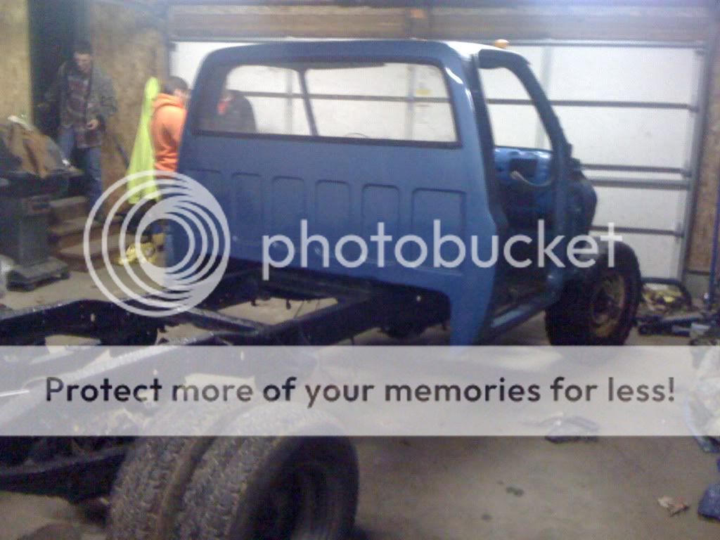

my exhaust is going to be ran like this
the exhaust will be slightly lower
this is how my truck sits now
it has the doors on since i took a pic

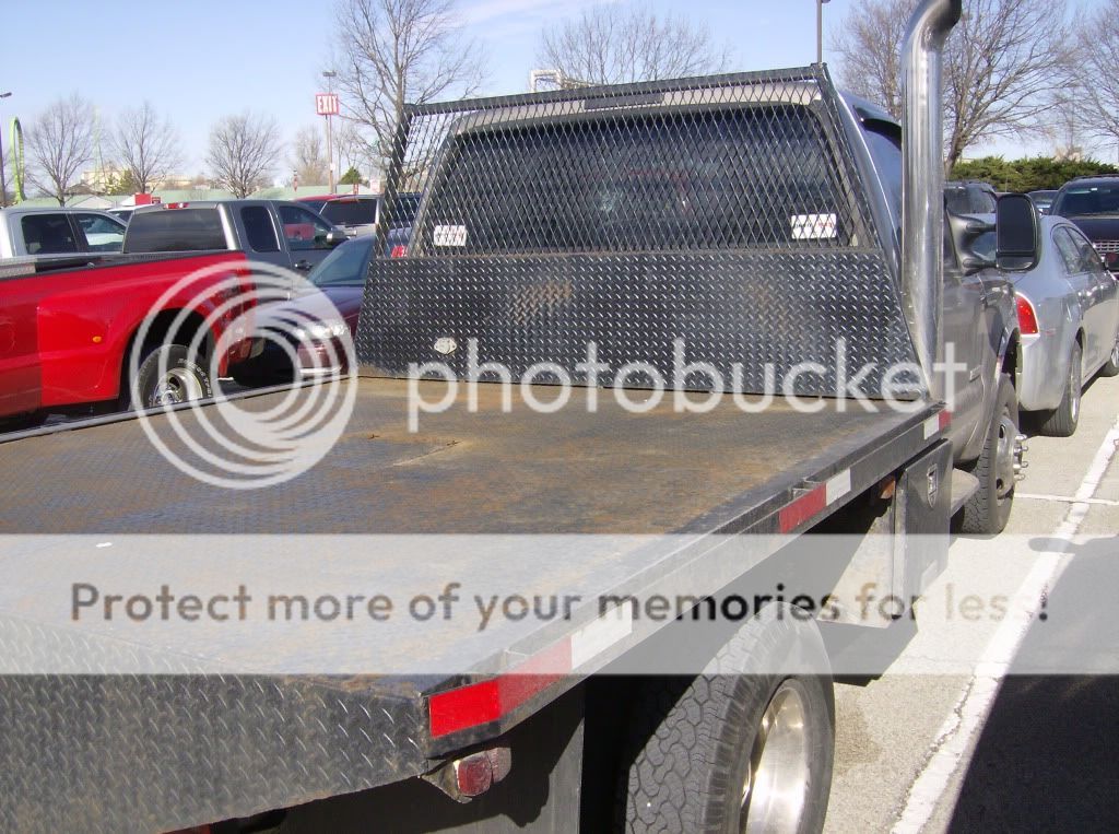

here is the flat bed to give you guys an idea of what i'm working with ;D

Anyways, after looking at the frame, you could have a custom tank built, but you would need to have it notched for the driveshaft, but check for clearance when the back of the truck is fully weighed down.
