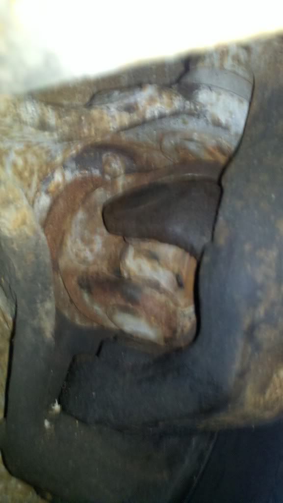

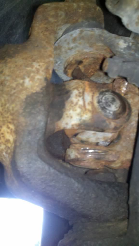

I just bought this truck knowing the 4x4 was out. The problem is where the axle connects to the back of the wheel. I'm not quite sure what these parts are called. Can someone tell me? I'm trying to do some research on what it will take to fix this and where to find parts, but don't know where to start.
Thanks for any help, let me know if you need more pics.

Axle shafts and u joints. rockauto.com or your local parts store.

How have you determined the problem?
The pics show axle shafts and u-joints. To work on them you'll need a spindle nut socket, should be available at you local parts store for around $15. You'll also need the appropriate seals for re-assembly, some snap-ring pliers, normal wrenches and sockets, and axle grease. While you're in there you might as well put the new bearings in it too. It's a fairly involved process to get everything apart, but not too bad. After you do it once, you'll be able to do them again pretty quickly. There are videos on youtube that show the process in pretty good detail. Changing the u-joints themselves is another matter. They can be in there pretty good. This will require a press or vice to push the old ones out, and the new ones in. You have to be careful not to bend the ears that hold them, or you'll never get the inside retaining clips back in.
You could take it to a mechanic and have it done. But if you're gonna be wheeling it much, you might as well learn how to do it yourself. You'll likely be back in there at some point in the future. I can swap an axle in mine in about an hour now, and be back on the road.
Do you have manual locking hubs? If not, now is a good time to do that upgrade as well.

Looks to me like you are going to need an outer stub axle too. You might want to check the ball joints and if they have play in them install new ones while your there.

Judging by the size and thickness of the parts i would say it’s only a Dana 44. blaz just had this problem over the winter in a plow truck, I’ve had this problem a couple times over the past summers due to my trying to turn 38's. He upgraded his axles to what he said. While me i just bought some off eBay and junk yards you can usually pick the shafts up used for 40-90 bucks a junk yard might make you buy the whole axle since it won’t be any good to them anymore for 100-200 bucks. But make sure you know what axle you have or it won’t fit.
