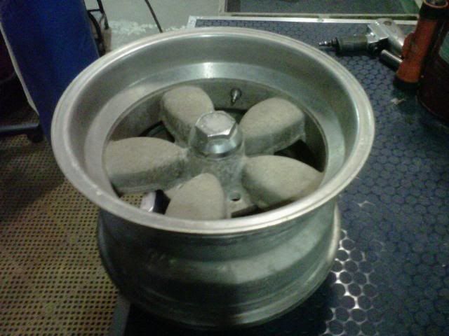

Thanks Randy I did some oven cleaner and sos pads and water hose the wheels look better but still long way to go.. Another 2 hours of work lol.. I'm trying anything lol

Keep trying. You'll find something to work. One of the issues you're facing is that most of the old vintage wheels such as your 70's era Westerns had a lot of Magnesium in the alloy. True Mag wheels such as Halibrands were almost all Magnesium. (Mags) Magnesium is very dark and doesn't polish well or hold a shine well. Today's wheels are made of high grade aluminum alloys with little or no magnesium, but I'm old school I still call them Mags.

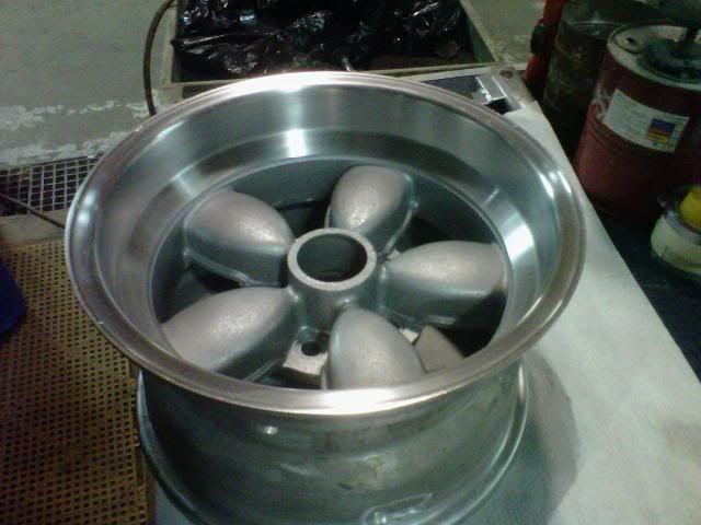

Very true I always thought there vintage so there have years of Midwest weather on them. Same time the quality was not as good as than like you said man.. I really dig the wheels there different not something I see on cars or trucks ya know.. A question though the lip the spoke part and center I can get to shine ok.. The in between is the part that really seems like maybe it not supposed to shine and have more of a silver color.. Dis these turbine-rocket wheels have silver a grey like in-between the spokes?? Any input be great

They were a cast finish between the spokes, much like the spokes on the American 200S I showed a pic of. I cheated, I painted the spokes on those with a cast aluminum paint and polished the rim. You could do the same on those.

I keep doing oven cleaner and sos pads. I put in 2 more hours on one wheel today still have to wet sand than oven cleaner again than I'm going to use a powerball and mothers mag wheel polish.. Still wool fine grit to.. Im not gonna paint in between the spokes.. That be a lot of tapping off and work I think this my only option just work wife thinks im nuts.. Lol

No need to tape off the spokes. You can just paint, then take some thinner and wipe the paint off the polished areas.
