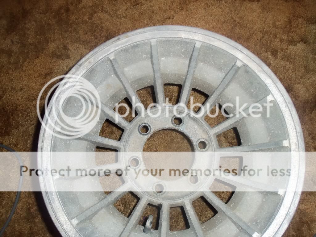

I'm getting confused on what I should do here so I'm going to post 4 pictures.. The first 2 are after I hit the wheels/rims with wet sandpaper 400 grit.. Also used mothers mag and alum polish.. I used a towel to apply and rubbed them.. I have hours in the wheel looks really bad..  I cant get the lip and spoke and center clean. The in between is corded and even with sand paper and scrubbing does not seem to shine.. I'm wonder
ing if in fact there suppose to shine?? Maybe the lip the center and the spoke part only come really clean? I'm not familiar as they from the 70s I just like the look of them.. The last 2 pictures are wheels used with dawn and brush see how rough they are.. I work on these just not sure of the approach thanks everyone maybe this can give you insight to help me more thanks so much like I said I know Chrome but I dont if these are polished or what I never messed with alum wheels/rims everyone lol
My finger pointing inside the spokes to show the corrison
Same wheel
The other wheel little to no work on these

imo your solution is going to be chemical. wether you use a wheel brightener/cleaner or acid; read and follow the instructions, complete one wheel at a time, do this in the shade with a cool wheel, have your car wash soap and hose ready(or pressure washer), spray the wheel and do not let it dry, you may need to brush them a little but probably not much. as soon as you feel they have soaked long enough(before they dry) spray them off very well and wash them with soap.
after this step you will sand the face, lip, and center with wet sandpaper then a 000 grit steel wool with the mothers polish.
Based on the pics I think this will be your best approach.
