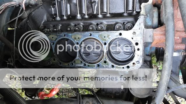

A few hours work and.....
cracked exhaust valve:
headless:
The cracked valve was sunk pretty deep in its seat compared to the others, but I think they'll all be pretty ugly.  Haven't taken the other head off yet, but I'll get it.

I ordered the Summit heads today.  Borrowed a telescoping gage to check the bores hopefully tonight.  Threw calipers just on the ridge and got 3.99", so I'm pretty sure they're stock bore size.  Checking bores from the top, should I just check them in two directions 1/2" down or so, and then bring that piston to the bottom and check it both ways at the bottom?  Anything with the heads off that can be done to evaluate rings?  It would be nice to have a dummy plate that I could bolt on in place of the heads and leakdown test it.  Should I just wait for the new heads, bolt them on and leakdown test every cylinder before putting everything back together?

usually pistons with an oversize bore have them stamped on top, so if there is no stamp, then pretty sure its standard bore, which seconds your measurements.

Those are stock pistons. Id know, i have them. You have a cracked valve, i have a cracked head. And strangely enough, my pistons are in the same position as yours....

The cylinders look like its got some miles on it, but no score marks and the size checks good everywhere I checked.  I'm willing to take a little risk as I didn't want to pull this motor at my house, I need to take it somewhere else if I'm going that far (no garage, no hoist, no stand).  If I could do the bottom end with the block in the truck I'd go for it.  I saw your post, '79c20, and it is kinda funny.  Your symptoms were pretty close to mine.  I halfway expected to have air coming out an adjacent cylinder when I did my leakdown test after seeing your post.  My best price for rebuilding my heads was $450, so I just spent $630 on new, better heads (shipping included).

Because they're hypereutectic and flat tops. Yours are dished cast pistons. Why wouldn't you replace them? To save $80 bucks having them hung on the rods? I'd definitely go that route.
