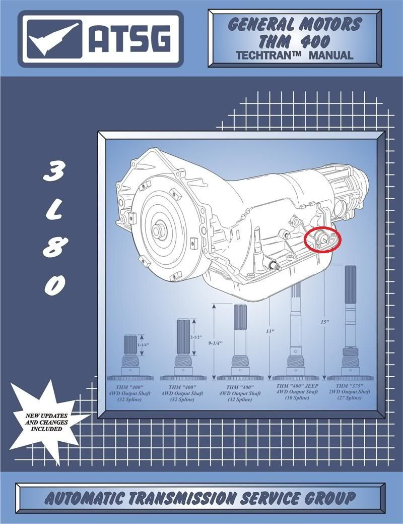

  Kick down is electric on a TH400
No TV cable like the TH350??
Re: swapping 267/th350 to 350/th400
« Reply #10 on: July 25, 2011, 08:59:15 pm »
The TH350 has a detent cable, the TH400 has a detent solenoid, the TH700R4 has a TV cable.

if it has a solenoid shouldnt it have a plug for a connector?, the th400 we have doesnt any connectors on it

agreed i my truck has the th400 and i have only a vacuum hose going to it and the shifting linkage
« Reply #13 on: July 26, 2011, 09:52:23 pm »
disagreed,
see image
Offline bigchevyc30
  • Posts: 456
  • the pig
« Reply #14 on: July 26, 2011, 11:12:36 pm »
so then whats the wire that hooks up for then and what would it do with out it hooked up cause i would like to know and on how i would wire it up. thanks for showing that vile i seem to learn something new about my truck every day
