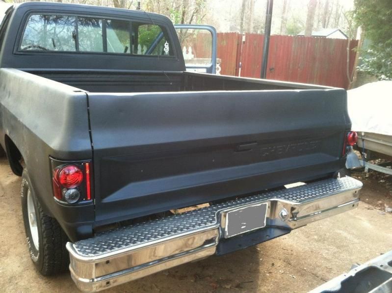

As it stands now, I have the bed and cab mounted onto the truck and everything is all put back together. The step rear bumper is mounted as well.
Basically the only thing left for me to do is put the interior back in and replace the doors.

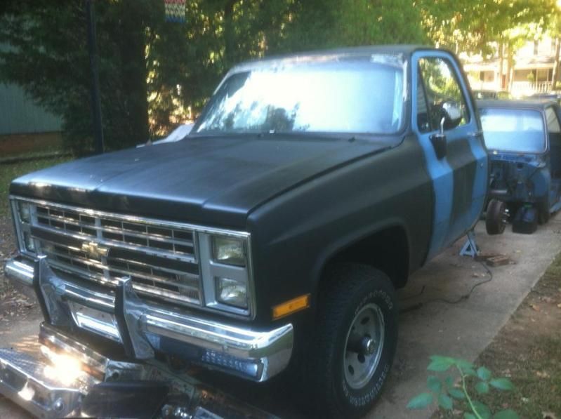

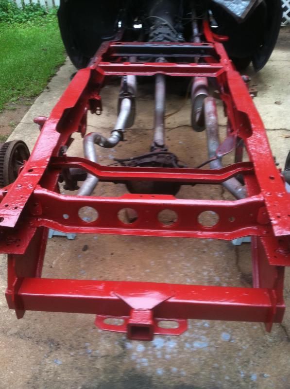

Painted the frame: (Don't worry... I painted it black after this. That was the only color of the rust sealer K-mart had and it was on sale. I went back over it with black bedliner spray so it is 100% black now!)
Got the cab on:
Friends who helped:
I put my old doors on to keep the water out:

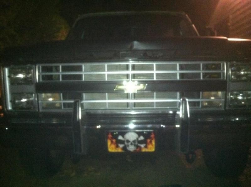

Gotta love the new front "bling":
How it sat after new years:

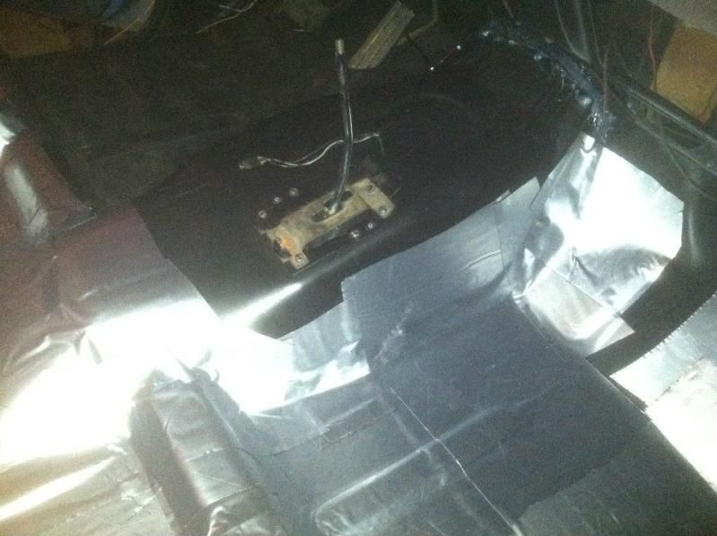

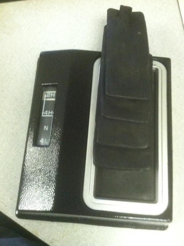

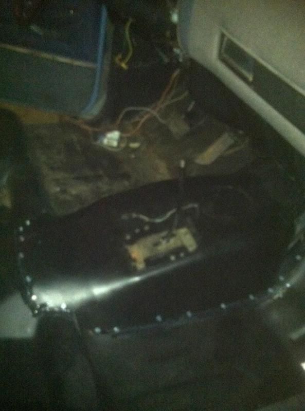

Okay here are some pics of what I did to fix the low hump issue:

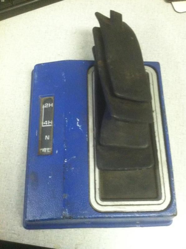

This was the shifter before sandblasting and painting it:
After:
Shifter cover before painting:
Shifter cover after:

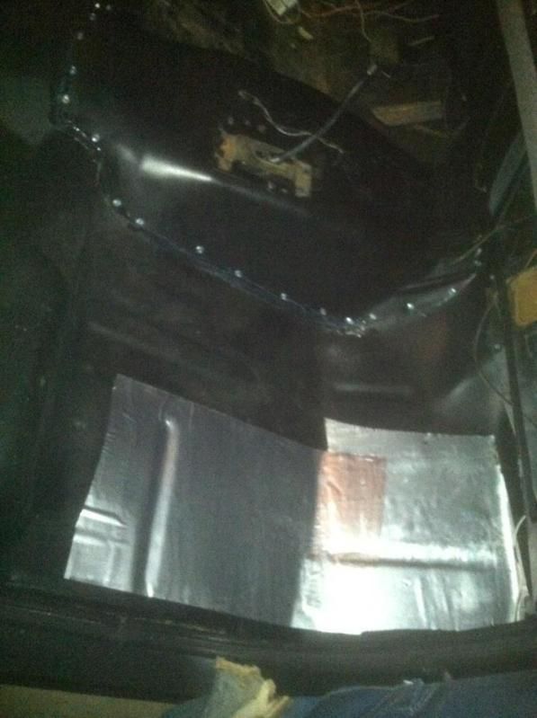

Dynamat on the floor:

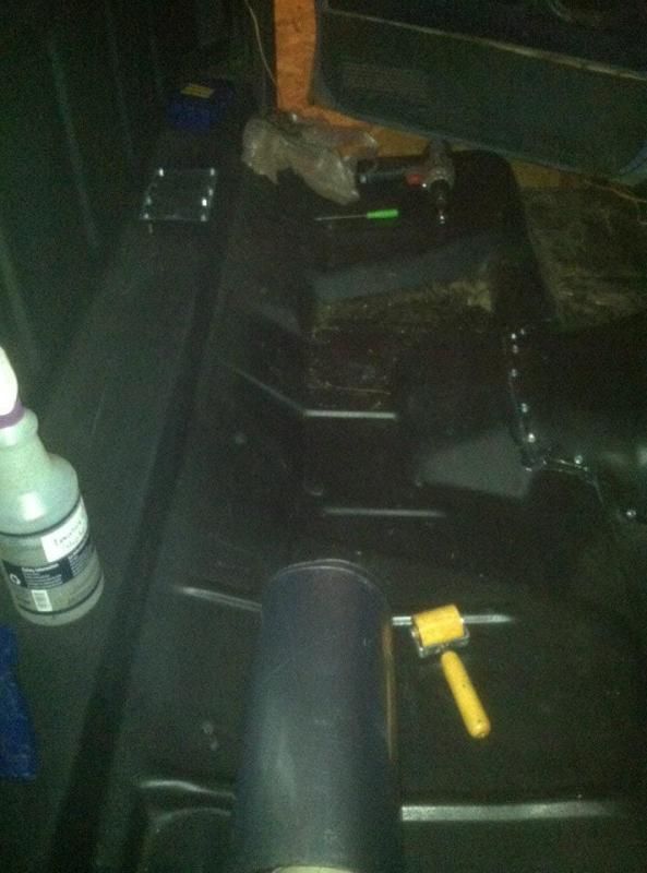

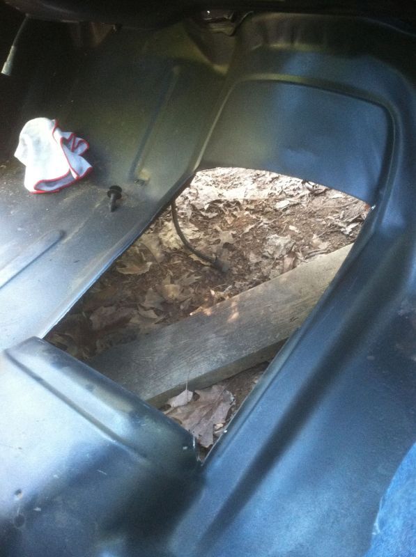

Had to cut a hole in the floor when I got the cab because the cab mount nut was spinning in place. I fixed the threads and replaced the mount, and covered the hole (I sprayed about a can of PB blaster in there before doing so in order to prevent rust).

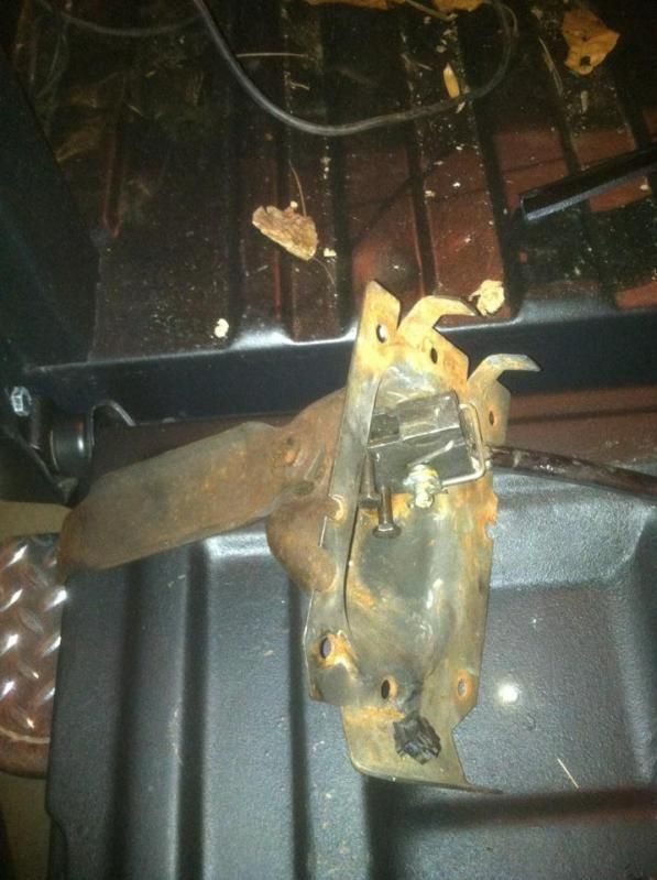

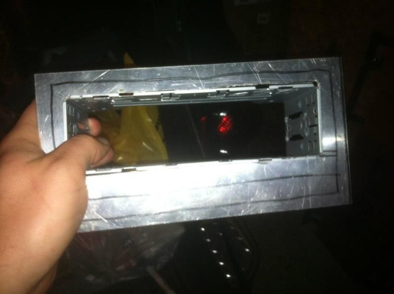

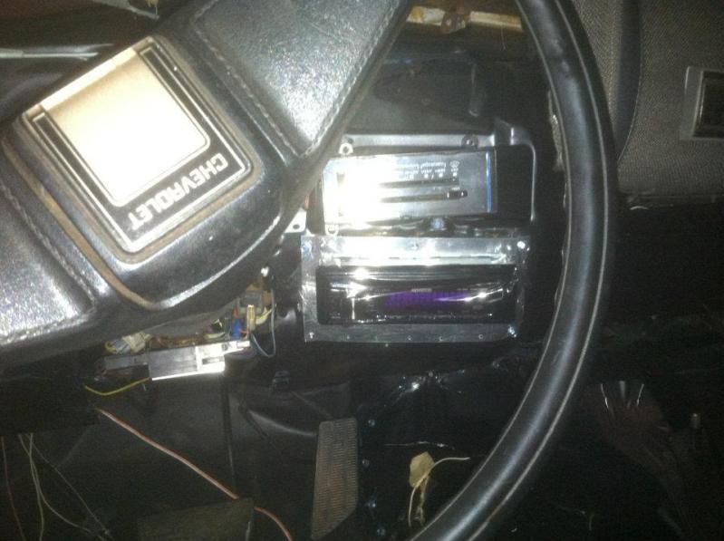

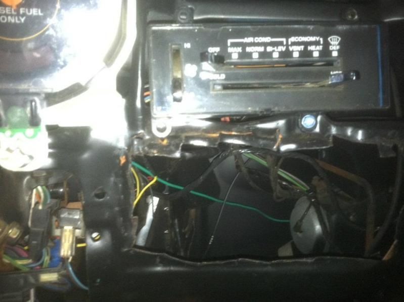

Fubared radio area:
Fix:

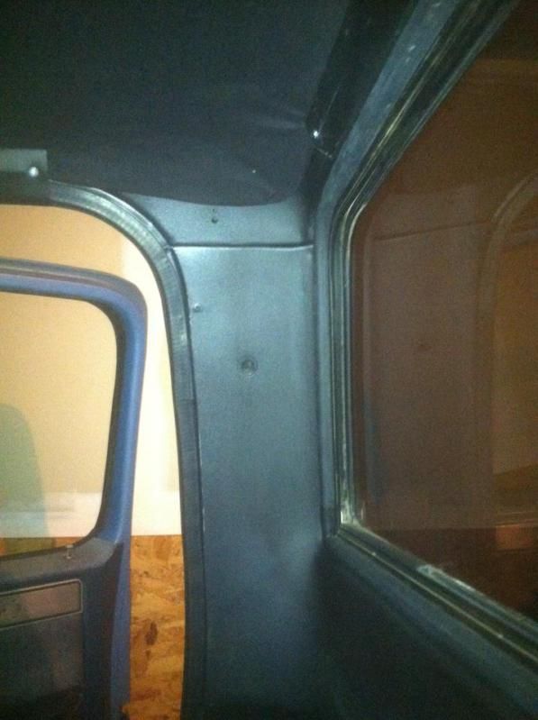

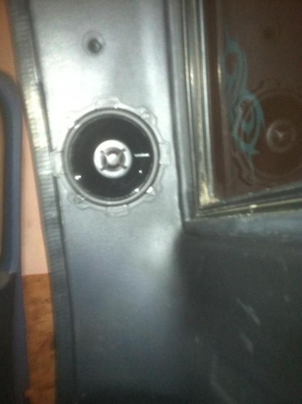

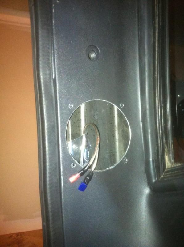

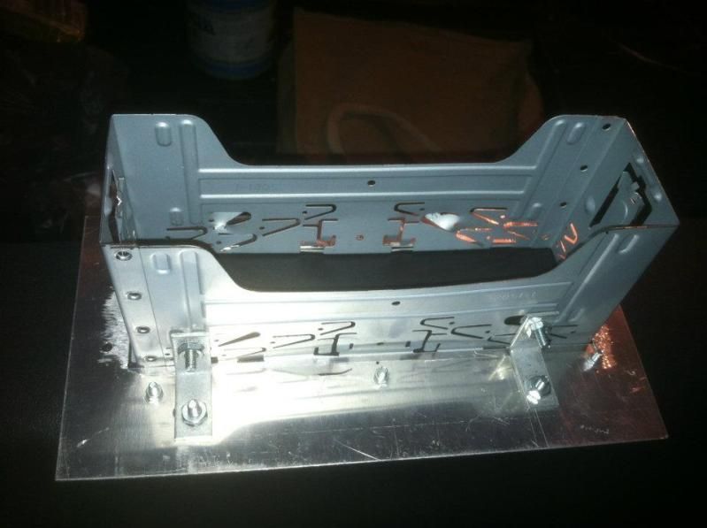

Rear speaker mounts (has anyone else done this??):
Before:
During:
After:

Nice idea on the speakers. How do they sound in there?
Ive only played them enough to make sure they worked. They sounded a lot better than the dash speakers did though. Im going to have to close off the spot here 6x9s go so the sound is a bit better.
