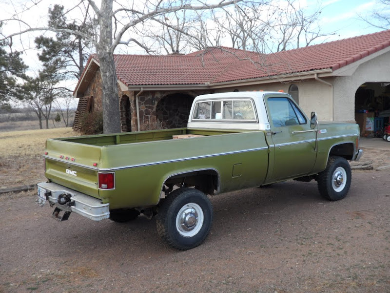

Here are some photos of my '73 GMC K2500 Camper Special.
Prior to propane install.

Great looking truck. That color is awsome for a truck like that.

Thanks Thirsty.  That is the factory color, I think it's called Green Gold Metallic.
The bed is a later mode that went on after i slid off an icy road coming back from a hunting trip. While i kind of miss the flush mount fuel filler caps, I don't miss the fuel streaks that seemed to be a regular occurrence.

Great looking ride, love the stock stance, hubcaps.  The newer style front bumper doesn't look to bad either.  What is it that is sticking out used for?

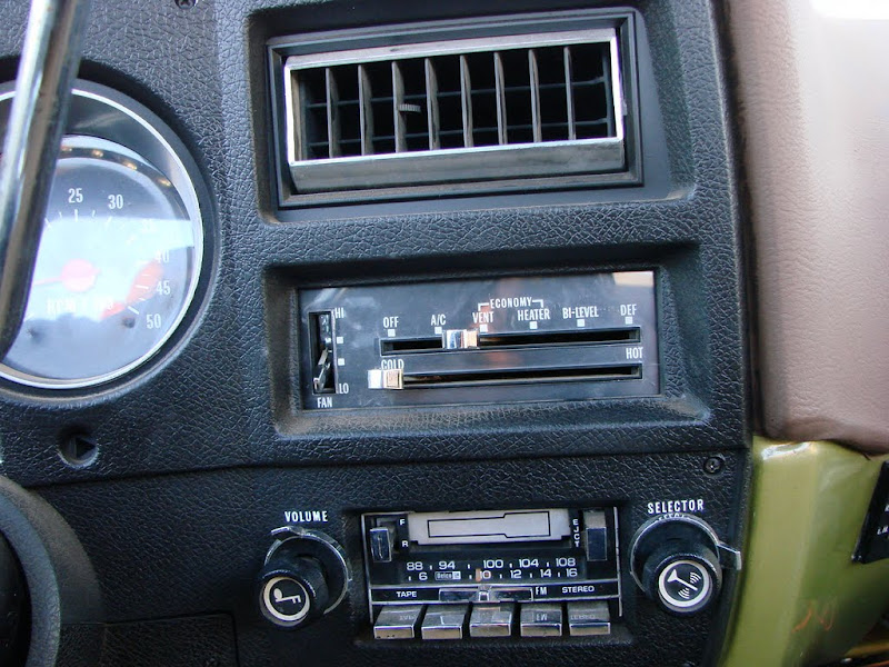

Here are some photos of the dash cluster and the Spicer lockouts.
The NP203 has a part time conversion and had some Warn lockouts when I bought it way back when. I had wanted Spicer hubs for a long time. About 10 years ago I called Spicer and ordered their current hubs, Powertrain, but they were essentially the same as the Warn hubs.  I found a decent set of Spicer Hub-Lok external lockouts about 6 years ago and swapped them for the later style.
« Last Edit: November 02, 2011, 06:00:37 pm by Jason S »

Nice stock touches, tach, stock radio...very nice.  I had those type of hubs on my 72 K20, never had any problems with them.
