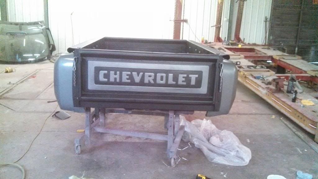

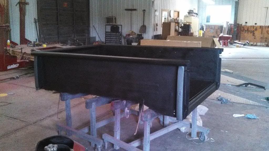

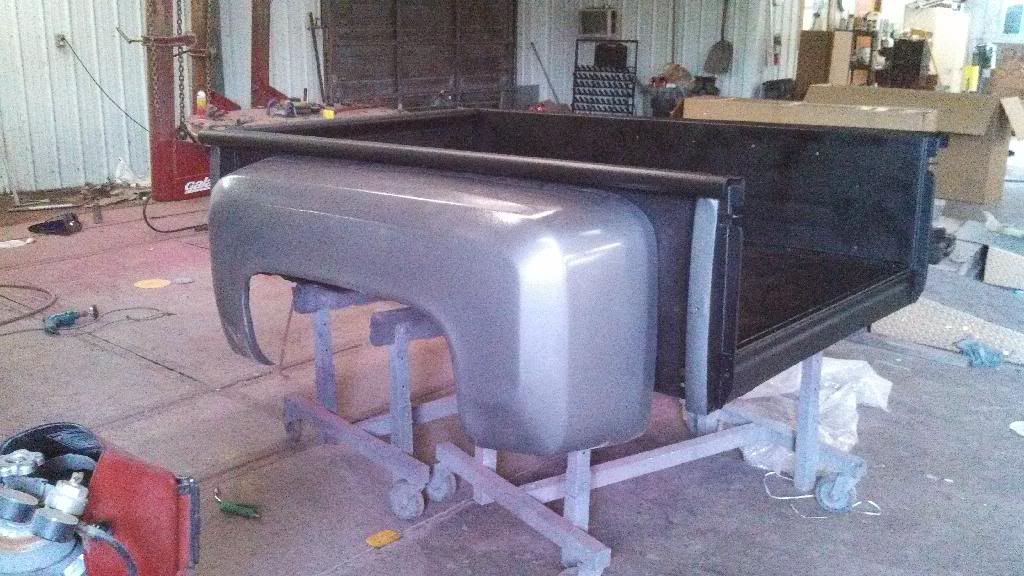

ive learned from my use that in the bed you need a really tough liner. the finish master that we use is hard as a rock (the inside of my truck is sprayed with it for easy cleaning) but with that being said it does not grip anything like a rubberized liner they make bed liner with Kevlar and all that good stuff in it now days so you can get the best of both words.
photo bucket isnt wanting to work right now. here is pretty much the bed finished.. it might be too much black we will have to see once its on the truck

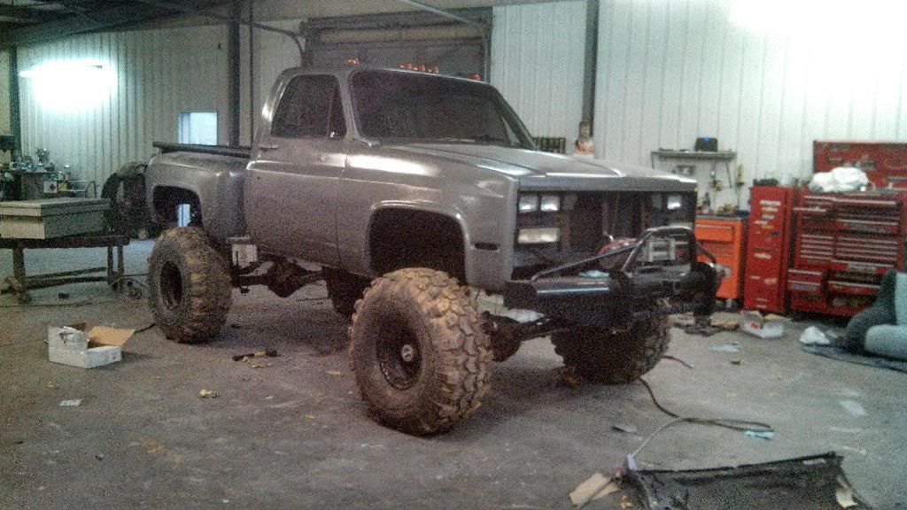

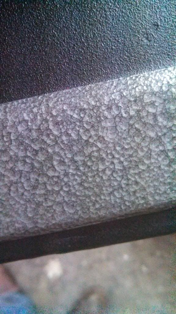

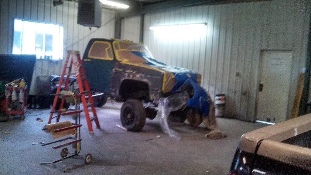

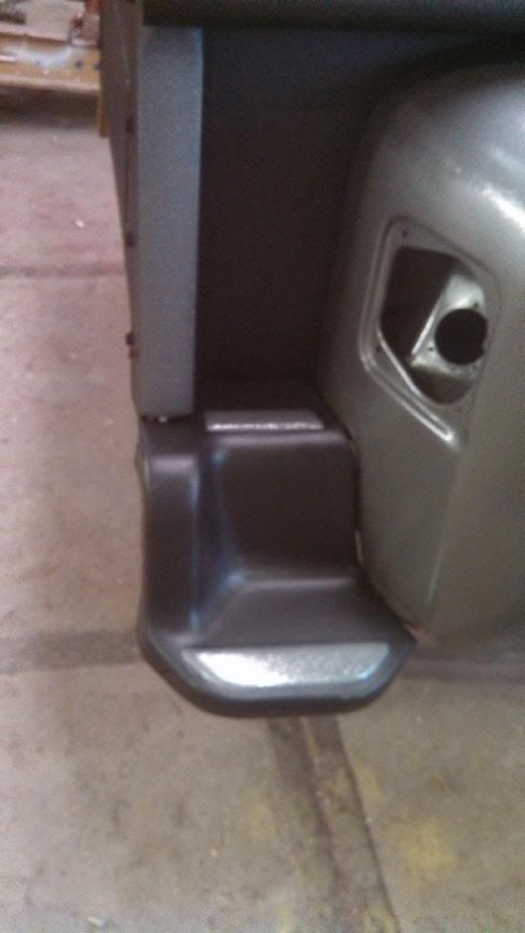

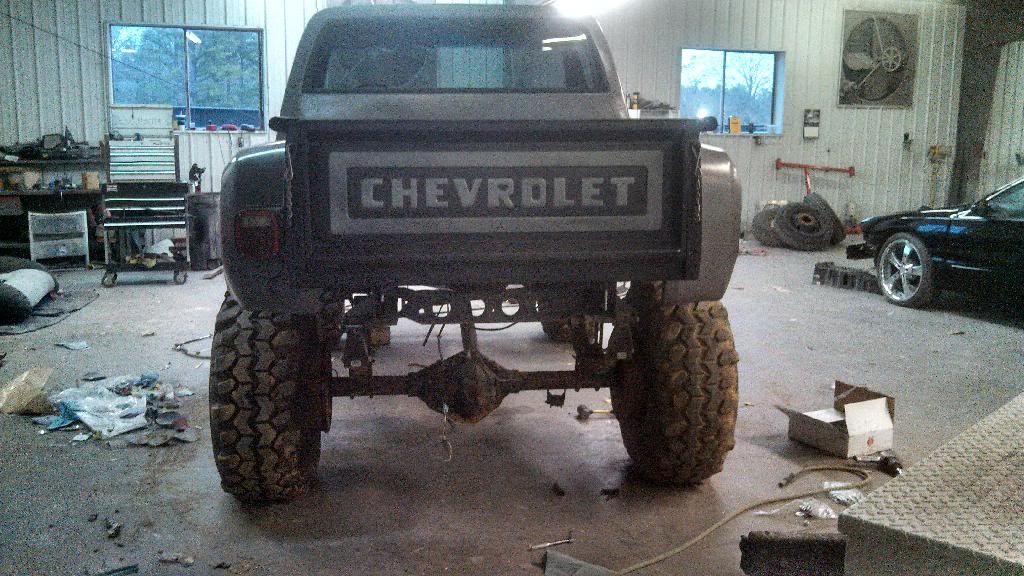

HERE WE GO! lol I was pretty excited today. I got a decent bit done this week especially with how busy we were at work. the paint isnt the best... but hey its a mud truck (paint cost: $30 + bedliner) the top half of the truck turned out great and then something happened... not sure what but i couldn't get the same pattern after that. im going to investigate and figure out why and ill probably re paint it once i scratch it up pretty good :)
Sanded ready for paint. we did a QUICK 5 minute tape up on her with whatever was laying in the floor (keep from wasting shop materials)
painted gray. i used the gray kind of like a sealer so i wouldn't have different color panels
lost my painted picture i had. here is a close up of the top half
bed on.
And there she is! :D
I still have a lot of work to do (always room for improvement)

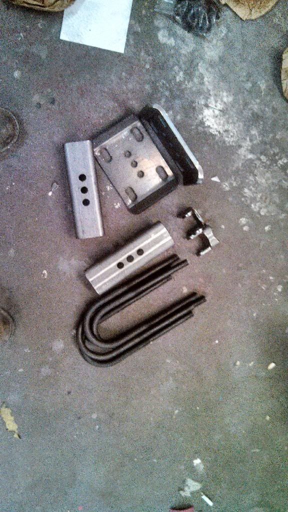

Hopefully next week i can weld on the new spring perches to correct pinion angle and bring my springs out where they should be (1 ton 14 bolt spring pads are 3/4" closer than the 1/2 ton)
i Need to cut the floor up and weld some of it up to finish my twin stick install
get my dash in and make sure everything functions
Then wiring! :D going to start on the dual battery's and installing some of the LED light bars
Last but not Least build a back bumper to match the front
Spring perch kit
