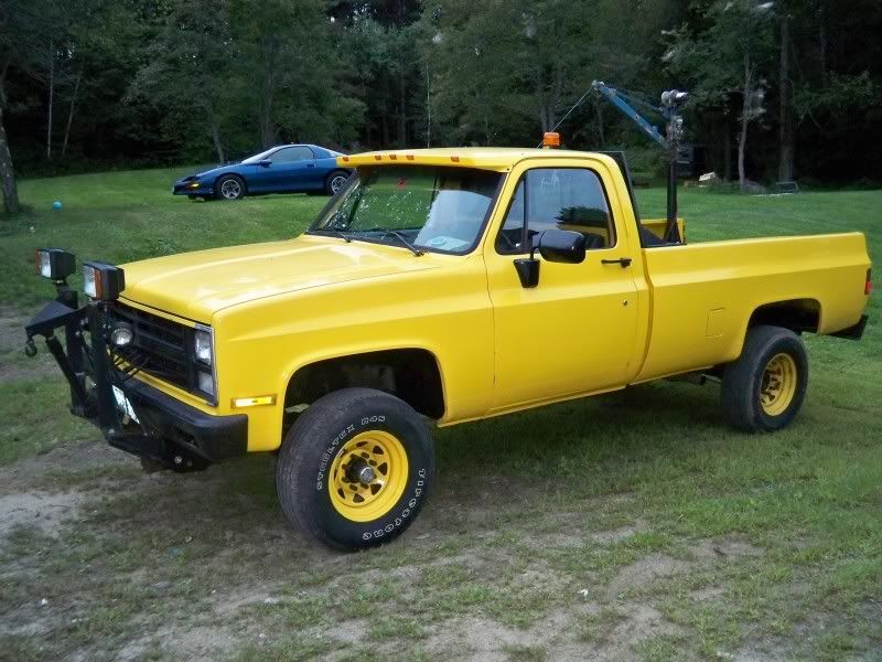

« Reply #8 on: February 18, 2012, 08:34:15 am »
You can see the famous yellow snow plow rig behind the magnum.
Re: Something went bang!
« Reply #9 on: February 18, 2012, 08:56:23 am »
This is Yellow Snow.
This is why its called yellow Snow!
« Reply #10 on: February 19, 2012, 08:08:35 am »
      Sorry I knew that, just forgot you nicknamed your truck yellow snow.  ???   I guess my mind was off in a different area wondering what in the heck actual yellow snow could mean. ;D

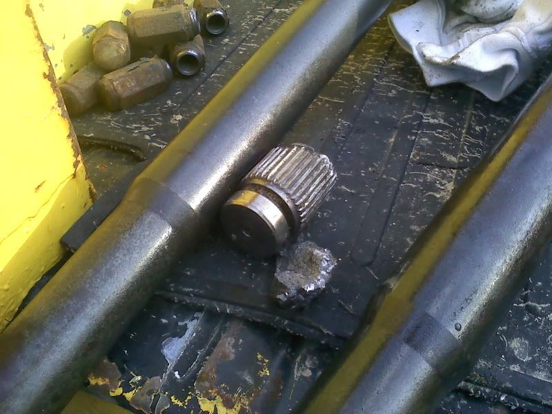

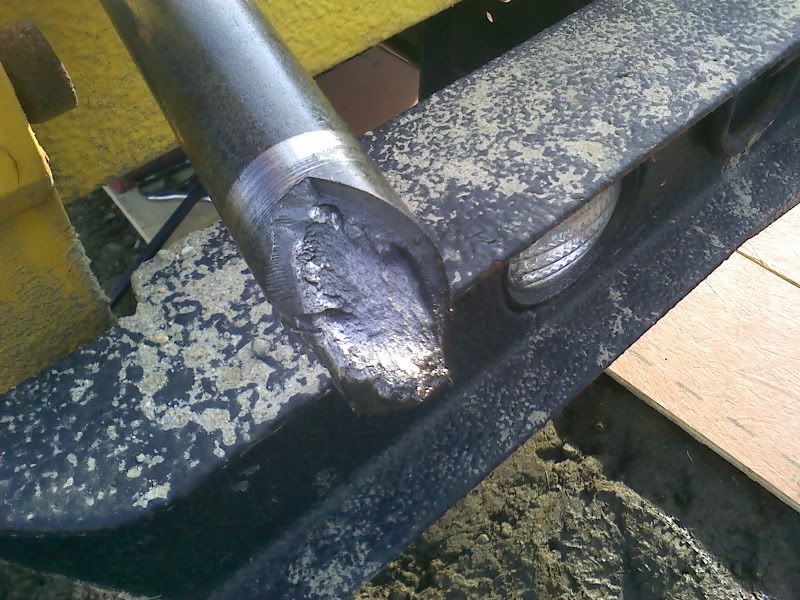

I found what went bang!!
« Reply #12 on: February 19, 2012, 08:37:21 am »
     Was that the outer spline part of the axle ?

« Reply #14 on: February 19, 2012, 09:04:57 am »
Boy did you luck out on that... That chunk could have wiped out the ring and pinion if given the chance, not to mention if the axle walked out...
