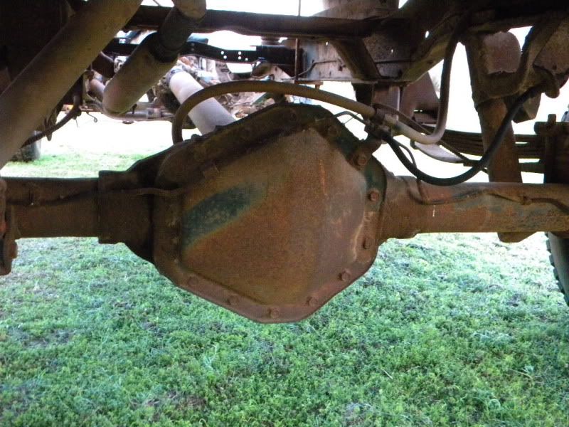

Should have a GM Corporate 10-bolt front axle, and the GM Corporate 14-bolt, 10.5", full float rear axle.

It looks like that's what I have!!! Here's some pics:
Front manual hubs:
10-bolt front axle:
Rear axle end view:
Rear axle:

Front axle is a Dana 44 with the factory Dana-Spicer locking hubs, Rear is a Corp. 14 Full Floater. If I had to guess you probably have 4.11 gears. As said you also have a NP205 transfer case and SM465 transmission. IIRC the transfer case is 1979-80 vintage due to the slip yoke of the 205. Someone will chime in if I am wrong.
