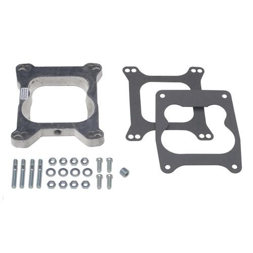

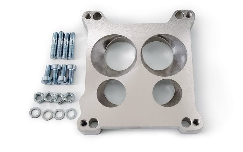

hey guys just got a new edelbrock 600 carb #1406, in the install manual it says that i should use an adapter like this to put the carb on a q-jet intake
but the guy at the local parts store gave my dad, who bought this carb for me as a gift, this adapter to go with it, but when i read the install manual it said not to use this adapter?
so basically my question is, is this adapter that i have not going to work or is it just sort of a cash grab from edelbrock trying to get me to buy their adapter? i dont really see how it could make that much of a difference? feel free to enlighten me
thanks

Trav, Not sure what the literature is referring to, but here's my thoughts. Either one will work, the engine will run fine...the side that is up in both pictures will go against the manifold.
 If you have a stock Q-jet intake then the top one will really be better since the air/fuel mixture will be going through the 4 holes in the carb down through the spacer & into the 4 holes in the intake. With the spacer in the second picture, the mixture will come out of the carb into the open spacer & "bang into" the large diamond shape area between the four holes in the intake trying to get pulled down into the intake. Most aftermarket intakes don't have the 4 holes (just a divider separating the 2 sides) so the bottom one could work fine there. Lorne

I have the first adapter you listed above...  The open one can screw up your low speed torque some, but it will work just fine.
The first adapter is better for stock type use, but either will work.\
The first adapter (4-hole) is for a dual plane intake, which you have.  the one with the huge single hole is for a single plane intake, which is for high end power, not low end torque.  but having the single plane adapter will screw up the dual plane workings.  Personally, I'd go swap the big open hole adapter for the 4-hole one.  they should cost about the same.
I just have a hard time taking the parts guys advice, there ARE good ones who know their stuff, but for every one who knows his stuff there are 50 who dont but are just as convincing at salesmanship.... ;)

Re: carb adapter?
« Reply #13 on: May 06, 2012, 03:08:53 am »
the parts store will have the adapter you need and should be the same price, its just the second one is more common than the first one. most the time when people get aftermarket intakes they just go as open as they can for better air flow.
